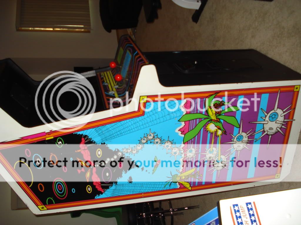

My black widow is nice. The monitor is in awesome shape the image is crisp and clean. the side art is all there not perfect but good.
The cabinet is nice but starting to loosen up a little. I would give the cab. a solid B for condition, but again it isn't perfect. The game itself works flawlessly and the control panel is very nice.

Part out for the major stuff to create a kit (CP, Marquee, pcb), in the condition you have, $300-$400 shipped. As for the rest of the stuff, harness, power supply, etc, maybe $100 shipped total. $200+ for the monitor.
Cab in that shape with the full side art would be a shame to part though.
