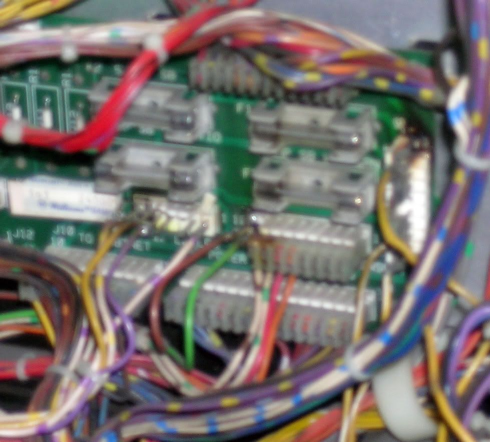

I am having trouble figuring out what is the cause behind the lower half of my backbox GI not coming on as well as the pop bumpers and the 3 lights in the lanes above them.
I know the problem has to be on the interconnect board and I know there is a lower voltage on the connector heading out to those lights but I cant figure out what to change to get it to work. I have the same issue on a rollergames as well and its the same sets of lights.
Im stuck and have a headache, any help would be great.
Change the header pins on the interconnect board for this line of GI and change the connector as well. You should also check at the connector for burnt pins coming from the transformer.
After you replace the pins on the interconnect board make sure you have continuity through the entire board! These board like to burn up their traces!

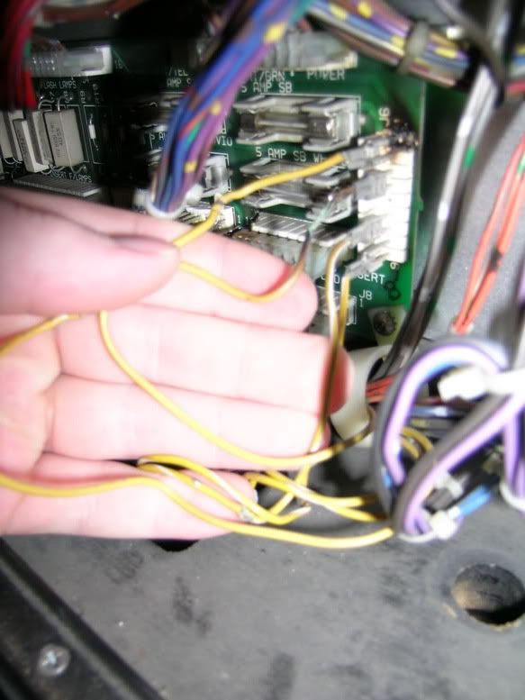

YOu would fall on the floor laughing or in disgust if I show you the board that came out of the Roller games. It has a fucking hole on it that someone just used jumpers to wire across the missing board. The bad part is that it looks like everything has continuity. Ill go check the transformer pins though.
Check out what I found when I opened my BK2K! Gotta love freaking dumba*$$*# repairing stuff! Dont take the mylar off that game BTW. Horrible idea. lol
