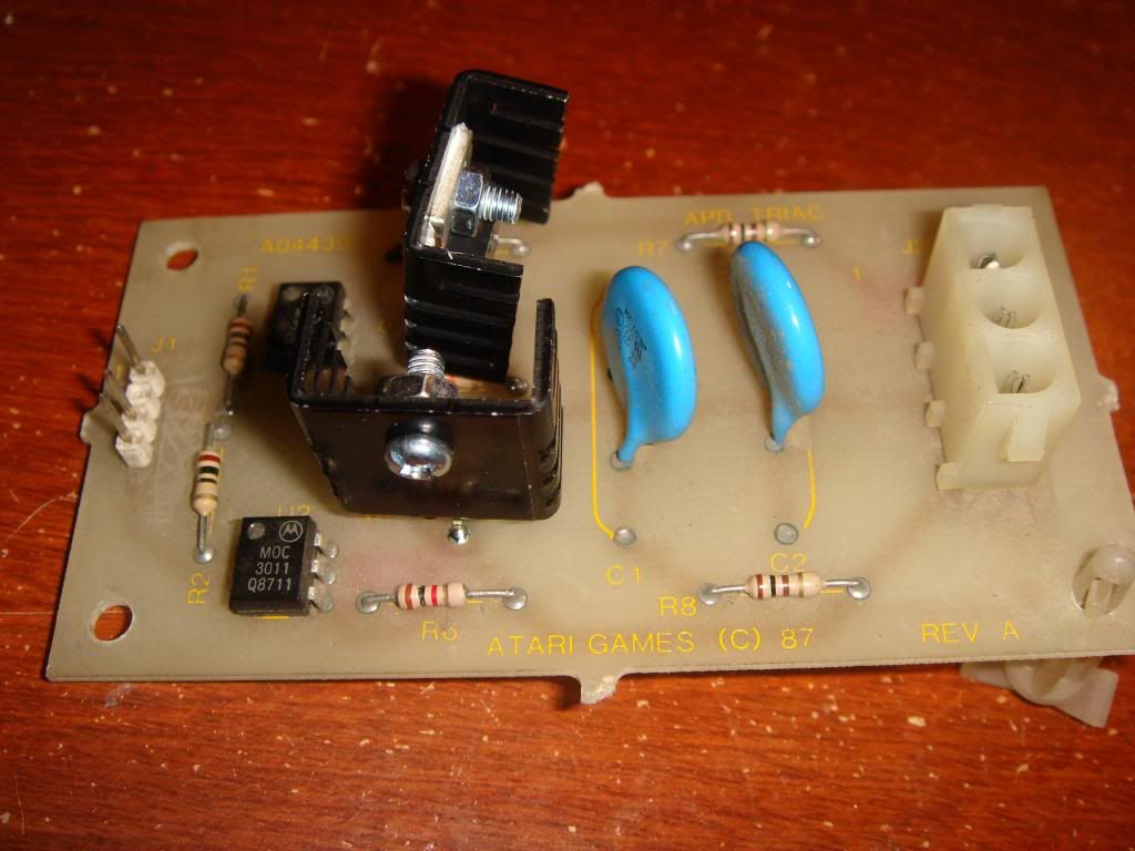

Just ordered parts from Mouser Electronics to modify the Triac board.
No longer will the old, expensive, weak, silver triac's be used.
I am planning to upgrade the triac (2N5756) to a modern beefier part number (MAC15SDG).
The original Triac had a 2.5 amp RMS current with a 25 amp surge (non-repetative!). Cost is ~$5 each
The new Triac will have a 15 amp RMS with a 120 amp surge! Cost is $1.49 each :D
Remember that a 60w bulb pulls about 0.5 amps, but inrush current on an incandescent lamp can be 12-15 times that of the steady state (7.5 amps on the high end). Keep in mind, that EVERY time the light bulb flashes, it has an inrush exceeding the RMS value of the original triac. No question why these fail over time.
Why am I doing this? Well, my triac board is defunct, I need to fix it, and honestly, this is cheaper to do.
I also want to confirm a Triac part # for fellow APB owners as I had a hard time finding information.

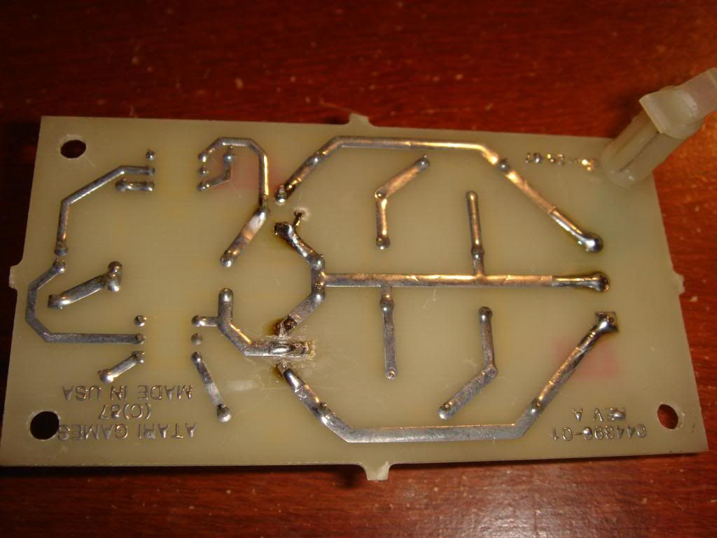

The Mouser Electronics order arrived today and I decided to change only the Triacs.
Got everything installed and working, just be sure to clean off any flux residue!
This Triac is a TO-220 package and does NOT have the same pin configuration, be sure to modify the board to accept it.
I drilled a hole for one, and redirected some of the traces on the other one. Very easy to do with a dremel tool.
Overall, A lower cost solution at about $10 for parts and shipping!
The parts:
Link to the Triac: ($1.49 each) Manufacturer Part #: MAC15SDG
http://www.mouser.com/Search/ProductDetail.aspx?R=MAC15SDGvirtualkey58410000virtualkey863-MAC15SDG
Link to the heatsink ($0.50 each)
http://www.mouser.com/Search/ProductDetail.aspx?R=230-75ABvirtualkey56720000virtualkey567-230-75AB

Warning!
I managed to get in too much of a rush to try the new board and didn't clean off the flux.
Granted, my flux is old and filthy (new can from the store for me soon!!)
So one of the lights started staying on... I thought it was broken again at first, then a bit of smell.
The MT1 and MT2 terminals had shorted allowing power to flow around the triac.
So be sure to clean the board!
I added a dab of liquid electric tape after cleaning just to be sure.
I don't want it to happen again (due to a spider, dust, or anything else).
