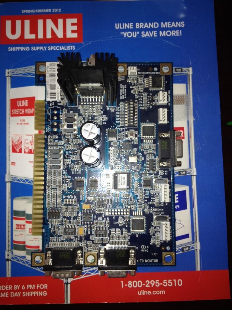

Can you play a BBH on a plasma TV? If so how do you connect the video?
The older style IT board versions not the new PC version .
I have a IO board out of a new PC version if I can somehow use it.
That's what I thought, so how do these giant LCD / Plasma light gun games work then? I've seen new BBH with LCD screens
I have this video board from a BBH pro, I wonder if there is a way to make it work?
Or do those newer games have sone kind of sensors around the screen?
I might be a little off, but my understanding of the older light guns is that they used the scanline of the CRT monitor to determine the position you are pointing. Any LCD monitors, since they just change the pixels cannot offer any information to these older light guns.
Any newer light gun game with LCD monitors will have some sort of IR emitters around the screen to help determine the location of the gun. For an easy example of this, look at the Wii with its "sensor bar" (really just an array of IR LEDs). The Wiimote is simply a lightgun viewing off of those IR LEDs.
