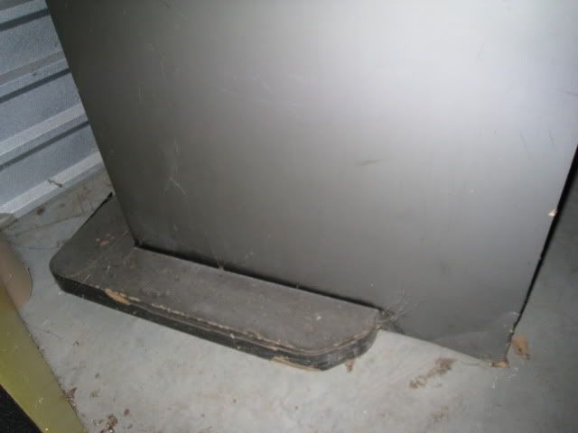

I have a seriously neglected Buck Rogers upright that has some water damaged partical board, which consists of some relatively minor swelling along the upper edge of one side panel and rotted away and missing board along the bottom edge. I also need to place the badly cracked front panel and the missing back door.
For the swelling I was thinking of using wood hardener, filling in the t-molding slot with bondo, sanding it all smooth and re-cutting to slot. For the rotted bottom I was thinking of cutting the damage out with a circular saw as straight as I can (it'll be about 4" up), joining a replacement piece with biscotts and re-enforcement from inside, filling/covering the gap with Bondo and of course sanding it all smooth.
Does this sound like a good plan? Does anybody have better ideas they'd like to share?
Ok here's pictures of the worst damage caused by the IQ-deprived previous owner, fortunately it is at the very bottom of the cab so hopefully any imperfections in my repair work won't stand out too badly. I've also found out that the original paint can just be peeled off in sheets with a heat gun, so it ought to look pretty good when I'm done.

I had a ratty looking Midway cabaret cabinet that was converted to a Arkanoid with water damage all along the outside edges. I decided to just make a Multicade out of it and sanded away all the loose wood particles and used wood hardener on the exposed edges. Then I used Bondo to build the edges back up, sanded and went over it again with putty. Finished it off with primer and paint and now you could never tell. It's not perfect, but it shows really well.
Unless the wood was soaked all the way through, I think this is the easiest approach. Otherwise, I don't see any problem with the method you outlined, especially if you're really good with wood. Personally, I wouldn't want to have to match up a new piece, I've done in the past, but it's not exactly my favorite thing to do...

If it were just the corner, I'd say to reinforce the base and Bondo it, but since it runs the whole length, I'd cut off the entire bottom and replace the wood. That's what I did with my Tron.
+1 for minwax wood hardener. Next time I have a really bad MDF/particle job I'm actually going to use a cheap injector (like for baking) and literally inject it to the center of the 'wood'. Stuff is awesome but careful, its 'thin', runs everywhere (brush it on for sure) and is hard to get off of stuff once it dries.

my method:
rip enough off till you get to good wood and start bondo'ing. don't sand before you bondo it likes it rough
I have tried 2 different methods on this
1. Lower the cab by 2", and remake the curves and T-Molding Slot
2. Remake the side/s entirely
The first method is quicker :D (Obviously)
3. I would consider the repair method mentioned above if the board was able to bear load. Otherwise you could reinforce the inside of the cab first, and putty away :)
