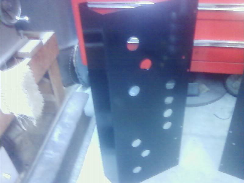

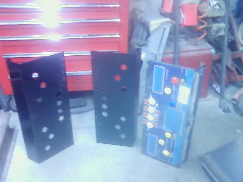

That bender will not come close to bending the metal thick enough for a control panel. Like said before there may be a problem with a radius bend instead of a sharp bend. Pacs, Galaga, Track and field and stuff like that you dont have to worry about the radius but games like Paperboy and Gyruss this is a big consideration. I have made several control panels in the past and i have the ability to make rounded bends. What kind of Cp do you want to make? Here is a T&F cp for an example.
