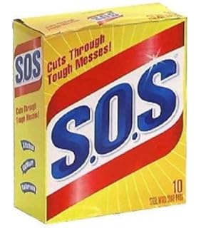

I usually wipe sheet metal with steel wool after the vinegar soak, just to give it a little more uniform sheen, but this is optional.
