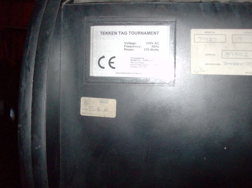

as soon as i see the tekken tag i was intruged as i had never seen the style of cab

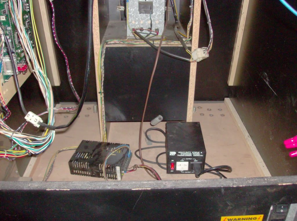

once i got it unloaded at home and start poking around i find out its a machine imported from europe as it has astep up transformer in it and all kind of stamps on the inside saying namco europe
and after a little further poking around ifind an interlock switch that was totaly falling appart replaced it with one i just pulled from a gutted pede and bam i have a awsome tekken tag with a27 inch hantrex monitor

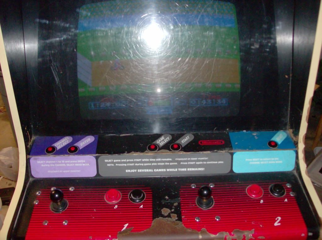

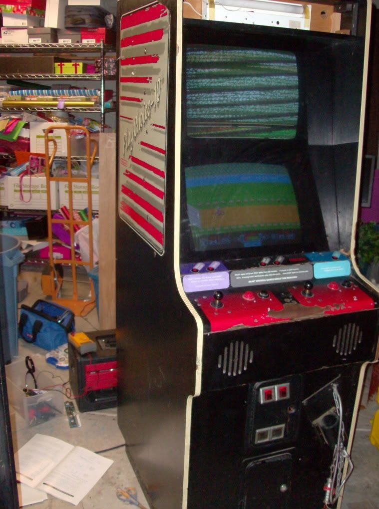

and on to the pc 10

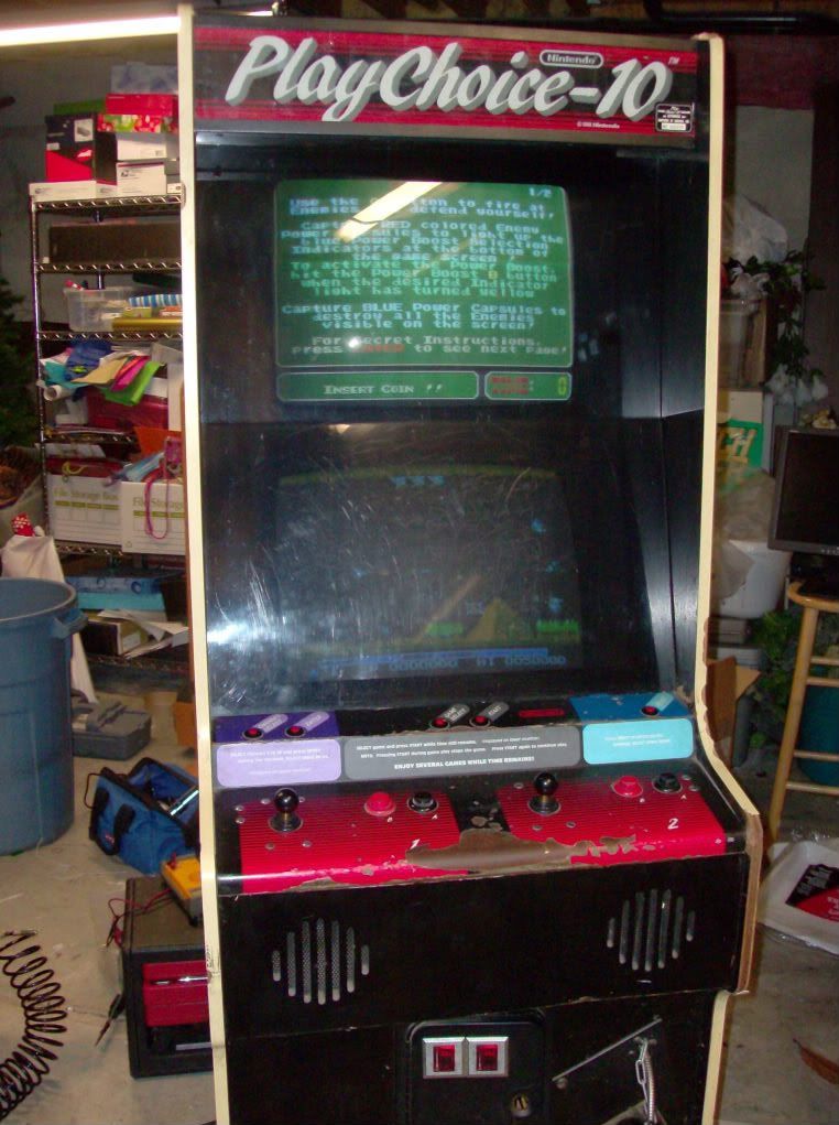

descent shape for siting in his garage smells like cat spray but i can fix that with alittle vingar

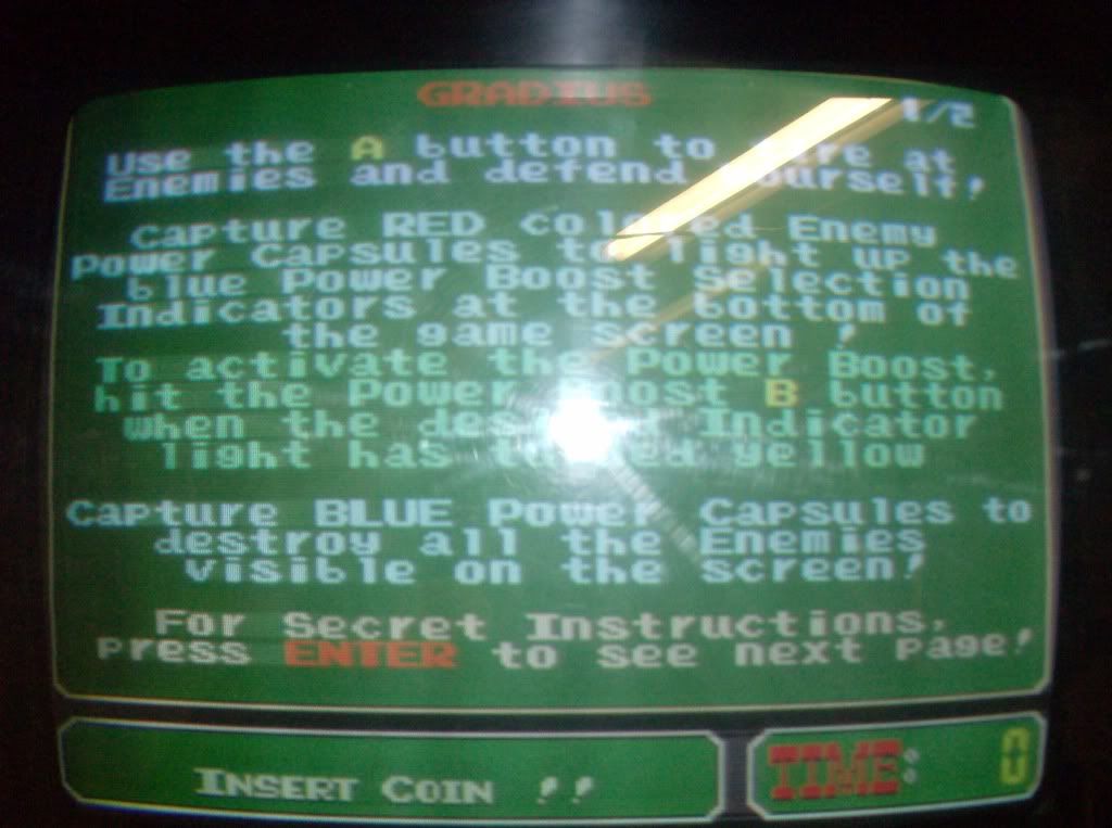

need to recap bolth monitors (and probaly a horz hold pot on upper monitor)

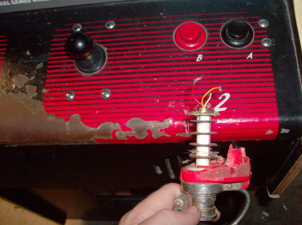

need a new gun (wires there but noones home)
new molding
and new cpo

but a little update 15 mins and agood horz hold pot from a ez chassis i had in my parts shelf and bam works great
(has slight jail bars but im 3caps shy of afull kit for this monitor ill live with it untill ineed to make anew order)

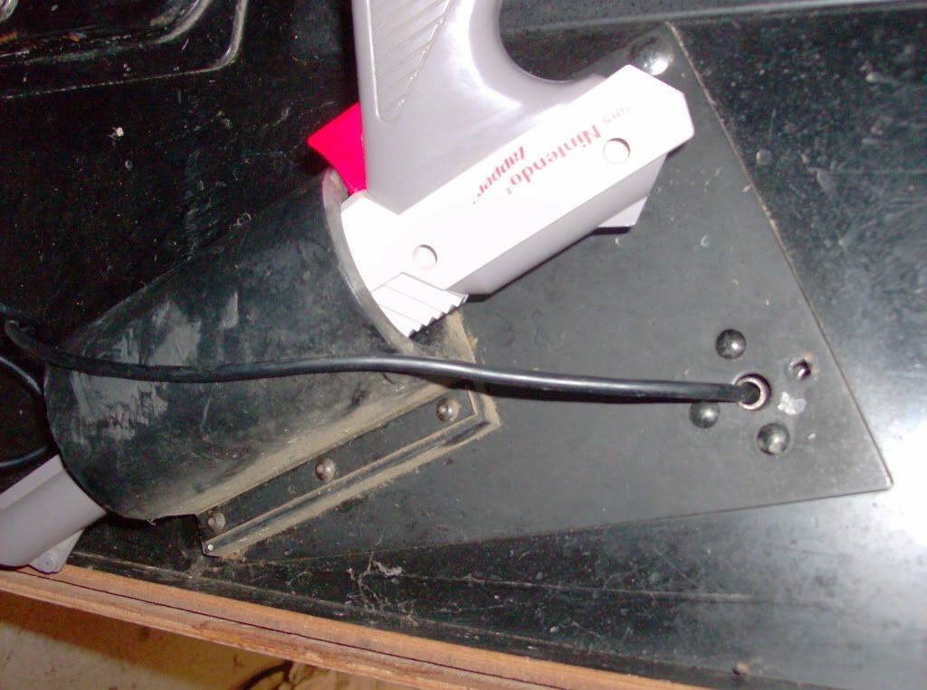

lol yup just messiin on the net and came across thebasmentarcade site and just finished hooking up a zapper to my cab need to pull the holster and run the wire into it and reinstall and im finished

i just finished cleaning it up and installing a cardboard bezl around the monitor
then luged it down to the basement (what a tight fit its 33 inches wide my doors are 35 1/2)

been bashing away on the pc 10 using my new zapper lol
its working perfect
i installed the wire thrue the holster like the original setup
but the nes zapper wire is fatter so i could not use the metal case that the old gun used
when i go pick up my new chips im gonna check if my guy has any revolver light gun carcases lying around so i can at least make it look somewhat like an arcade gun
