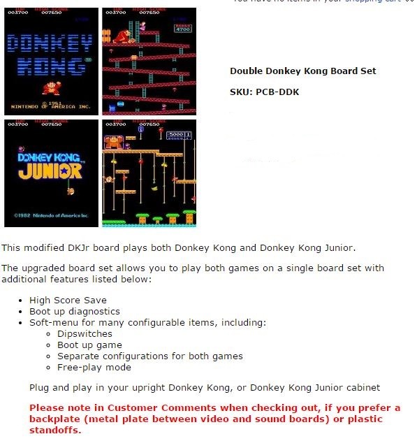

or sell both boards and get a Double DK boardset :)
https://www.mikesarcade.com/cgi-bin/store.pl?sku=PCB-DDK

I personally wouldn't do the double dk mod. some say the sound differences bother them, but would just rather not modify a perfectly good working board set.

The double DK board makes your DK use DK Jr. sounds. It's kind of like playing Mortal Combat and and Johnny Cage is yelling "ha-douken". Not for me.
