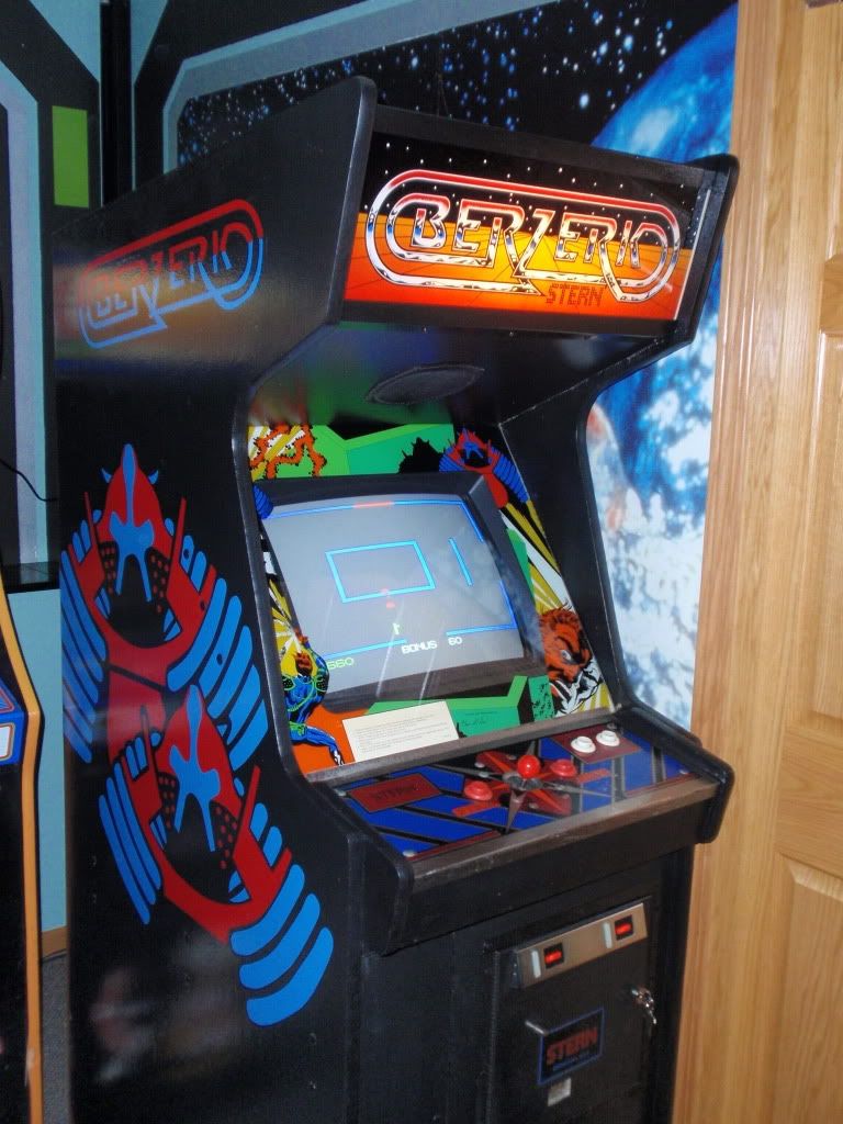

Yeah, I rode the ridge with steel wool to tame it down, but did not completely sand it flat if that's what you mean. The cab is so textured that it's hard to focus on any one spot with an abrasive without ruining or flattening said texture out and giving the cab a 'bald spot'. Ironically I saw 2 factory Berzerk cabs on Saturday, and quality did not seem to be a concern to Stern. I noted several stencil mis-alignments and overlap ridges, in addition to differing placements of the logo from one side to the other on the same cab.
Done
Forgot to add the finished pics to this thread. Overall, happy with the resto, but there are a few things I'd do differently if I did another Berzerk. I'd most definitely go with standard Rustoleum Satin Black rather than go with a custom black, as the custom black turned out more Dark charcoal than true black. I'd also sand the horrible texture off the machine and start over with an more even texture. I tried to keep the cabinet original looking and feeling by emulating the factory finish in artificial sand texture. It worked, but since I didn't like the haphazard look of the original finish, I didn't like having to emulate it. Anyhoo, other than CNlmoore's repro CPO, this is done:
