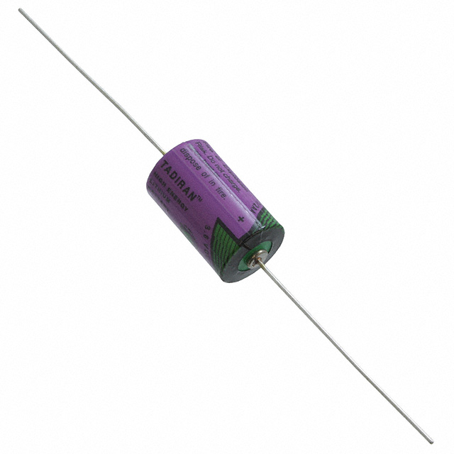

OK, so I've got the machine running, and of course the old battery has been removed, but I want to keep my "high" scores !
I've seen the solution from Tranquility Base with a loose phone battery and some rather long wires, but I'd prefer to install a lithium cell on the board instead.
The Lithiums will last at least 10 years and this mod has been done often on Williams boards.
However, Williams boards don't charge the batteries. Berzerk does.
In theory, I should be able to "block" the charging supply with a simple diode. Once the machine is off, the battery will supply it's voltage through the diode.
Not sure if that will work OK on a ZPU board.
The other alternative is using a Ni-MH battery like this:
This _can_ be charged and provides the right kind of voltage. However, I was wondering if the IC to store the hi-score data on might be drowning out this one too quickly ?

In these applications the amp hour rating is not an issue, as the current draw is minimal. The problem with rechargables here is the self-discharge rate. Regardless of the battery's capacity, it will likely drain itself in a month's time if you don't turn the machine on to recharge it.
Your best bet is go with a lithium cell and a blocking diode.

I just installed a 3V lithium cell and a holder on the ZPU PCB.
To prevent the charge voltage from reaching the battery I added a blocking diode. I installed it by lifting up one of the legs of R29, the one near the + battery connection. Solderderd the diode to between the loose resistor lead and the original soldering island of the resistor, so that it blocks the charging voltage.
Measured everything and everything is OK. The 5.3 Voltage that is trying to charge the battery doesn't reach it, and when powered off the 3 Volts nicely reaches pin 18 (Vss) of RAM 1E.
However when I start up and play a couple of games and register the scores, then turn off the power of the machine and boot back up, my registered scores are gone.
I checked the datasheet of the 6514 RAM and is says Vcc minimum voltage is 2 Volts so the 3 V at the pin should be OK.

If you put in a 3 Volt battery and a diode... you should not read more than 2.4-ish Volts at the IC, With a possible additional drop through R29, this may not be enough to sustain the memory. (I know it says 2.0Volts but it is probably very old too)
You say you actually measured 3.0 Volts at the IC, with power off?
As a test, you might try attaching the battery and diode directly to the chip and power cycle it. (bypassing R29)
If that still fails try adding another battery in series (3.0V + 1.5V) and the diode to see if the higher voltage gets you anywhere.
In theory yes. However, batteries generally have a little higher voltage than specced. The "naked" battery measures 3.35V This is normal. Indeed the resistor and diode-drop lowers this voltage a bit, and the result is 3.08V at the RAM.
My first thought was about bypassing/removing the resistor too. Not sure if it's needed at all in this set-up (guess it's there for the charging, but I'm not sure).
Yup, checked it again now (after 14 hrs.).It really should be enough. I think this is not the original 6514, it looks like it's been replaced on this board.
Gonna try bypassing R29 and also another type of battery that is rated at 3.6V (Like the original battery). Will also try a another 6514.

Aaahhhh, the sweet taste of success after some struggle !
First I have to kick myself in the but (pretty hard to do). I found how to clear the memory in the service manual, page 14. I should have known ! RTFM ! :D
So cleared it, played a game, saved the score, power-cycle and YES the score is saved !!!
I decided instead of hooking up the diode to resistor R29 I would simply _replace_ R29 with the diode. Using a schottky as Mark suggest may actually be a good idea, I do get about of a half volt of power drop and measure 2.8V at the RAM now, but that should still be enough.
Anyway, this set-up works. I much prefered to go with the lithium solution because replacing it again with a chargeable battery would give worries about charging current, number of cycles it can go through (the battery I wanted to use can only do 1000 cycles as per Varta's spec. It's simply meant as a "stand-by" battery (like in fire alarms that are normally powered up 100% of the time).
Also, the lithium will stay good for years and is very easy to replace without soldering.
