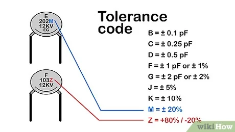

Howdy! I have clipped a part of a monitor schematic and was wondering if someone could help me understand some of the values on it. I have highlighted a few areas of the schematic and would like to ask...
1) C67 and C63 use J values instead of uF. They're also not-cylindrical electrolytic capacitors. Is the J value different than uF?
2) C59A doesn't specify 104uF, is that assumed, as it just read "104-100V". Same with C53
3) R101 simply says 120, so I'd assume 120ohm, but is there an assumed wattage implied?
I've also included photos of C67 and C63.
Thanks in advance for helping me along!schematics help.jpgimage1.jpegimage0.jpeg
Learn the cap codes:
The J is likely a tolerance code:

For resistor wattage values, you generally find a note in the corner of the schematic which says "Resistance at 1/2 watt unless otherwise stated" or something similar.
Those aren't electrolytics, and seldom go bad. Why do you think you need to replace them?
