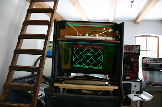

currently doing a Battlezone restoration.
http://bencao74.blogspot.de/search/label/Battlezone
I found an issue on my BZ
this is mine
this is from biltronix site
So I`ve a shift somehow in the x axis. Does anybody know this kind of symptom?
Thanks
For the rest of that slant, you'll need to adjust one of the two metal rings with tabs on the monitor. They are on the yoke. That will square the picture up with the monitor.
You're going to need to rotate the yoke slightly for the 'twist'.
Moving the rings will only help with the centering of the image.
Thanks guys,
the two rings was a little bit rusty. Finally I managened to move them. The radar is now perfectly in the red ring of the graphic bezel. Before that I tried to move the bezel, this was not the best idea :)
I get rid of the slant by rotating the yoke. Do that very carefully. ;)
