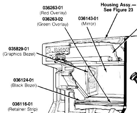

Since I'm sure the monitor has been moved around in my battlezone, as I'm tweaking the placement of the gels/backdrop/monitor position....trying to get it perfect....
I'm noticing two areas of monitor placement on the brackets...you have play in the monitor bezel bracket(that I scooch towards the periscope)...and you also have an adjustment of the monitor frame in the monitor wooden bezel itself....on mine, it's currently with the space towards the green gel(I think that's wrong and isn't lining up with the backdrop)...
I've looked around for a while and I see on most BZ monitors the space is towards the red gel....or, better put the monitor is slid towards the periscope on the underneath bracket for the whole monitor assembly, but slid towards the periscope also on the monitor frame it self.
Just wondering where you guys have it set, just to get a consensus to find for sure what was proper from the factory..

I need to re-affix the gels to my monitor too. Someone had swapped monitors at some point (from the burn I can tell it was from Omega Race), and they made a nice mess with duct tape to put the gels on. I got that all cleaned up and now I want to put the gels back on cleanly/correctly. Can someone with an unmolested monitor measure where that red/green division line should be on the tube face? Also, I assume the two gels just get butted up together as best as possible? Or do they get overlapped slightly?
They overlap slightly...a maximum of 1/8 of an inch so the manual says.....I had to replace my green gel. In the pic above was the result, I tried to follow the manual's instructions for placement...but from pics I've seen it's all over the place... I did try to place it where the originals were but that may have been tampered with too on my game.
From the manual:
"If you must replace the monitor, place the red
and green overlays on the face of the new pic-
ture tube as follows. Place the red overlay within
the top 4 inches of the screen; then butt up the
green overlay to the red one. (These overlays
may overlap by a maximum of 1/8 inch.)"

Most of them are taped to the tube from what I've seen(like the two examples above as well as others I've seen)...and the cardboard bezel just sits on top....here's another example from a post here on the forum(not mine, just saved the pic for reference, TY to the original poster): The manual even states it's placed on the face of the tube....but it's vague.

I didn't add the extra wood or realign the monitor. I just have the gels attached to the black cardboard bezel and lying on top of the CRT.
