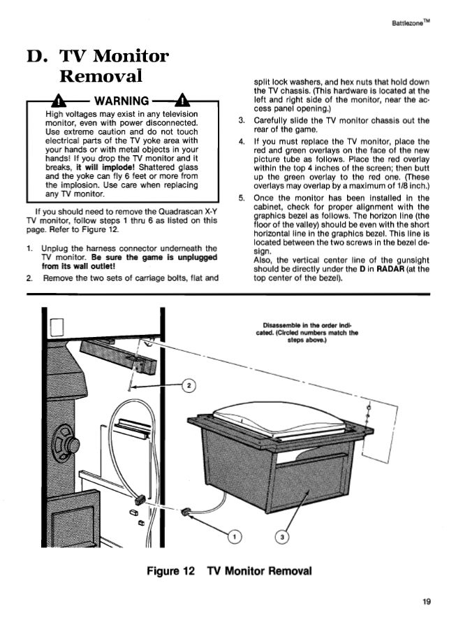

Pulled the whole monitor?
It comes out the front (which actually wasn't clear to me the first time I tried, lol). You just need to take the front off of the game. If you had it powered up recently, you should discharge the tube just to be safe, if you are going to remove the HV cage.
You don't need to discharge it to remove the monitor from the cab (and you physically can't do it easily anyway, while it's in the cab). But discharge if you're going to mess with the tube. And contrary to urban legend, you can discharge it with just a screwdriver and wire lead. And HV probe isn't needed to discharge (though you should have one to set it up, as you should measure and adjust the HV properly.)
Id rather not pull the whole frame and tube out. Can I test these frame transistors with it in place?
If this is a BZ upright, the monitor comes out the rear of the game.
To analyze it correctly, the OP should remove the assembly and test on the bench.
You can, but you really should remove the deflection board and inspect it for broken solder joints and wires too (which I think you can do without removing the whole monitor? Not sure if it'll fit through the opening in back, but I think it probably can.)
But you can probably test the transistors with it in the cab. Just be careful with the wires, as they like to break where they connect to the sockets on the frame.
