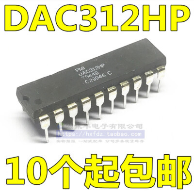

On my board, in slot A9, I have a t9741 dac 312h. On the schematic, it says it should have the AM6012ADC.
Considering it did work, I assume that I am either looking at an incorrect schematic, or someone found a replacement that worked.
it should be a AM6012ADC
are you reading the numbers on the other chip wrong? I found nothing on that number.
DAC 312 is a sub for a 6012. They're the same thing.
I think DAC312's might still be made, but are crazy expensive. You can get gray-market 6012's cheaper on ebay. But you should test the chips in a known-good board either way.
Also, you mentioned that this board had work done in one of the DAC areas. You should check that, and test the DAC in another known-good board, to make sure it's bad. Always suspect prior work.

Ah, so with just the +-5v gnd +-12v, the dacs should operate properly? Honestly, I'll replace them anyway, but learning to power and identify issues with ICs is probably a worthwhile skill
And Philips has a dac312 with the same pin count. Unsure if it's compatible with the one from all play(name check, the play symbol)
That's $6 on eBay, which isn't terrible
The game board logic needs +5V.
The video section of the game boards needs +15 and -15V, and a separate +5V that is just for the DAC (which you can jumper from the game board's +5V, for test purposes). The main game board normally takes in +22 and -22V DC from the AR. The game board has its own onboard regulators, which regulates those down to the +15, -15, and +5DAC. But you can apply those three voltages directly, after the regulators, if you have separate bench sources.
Got a link to the DAC312's you're seeing on ebay?
Nevermind, found it.
I'd be a little cautious of that seller. 95% feedback, with 150 sales. They might not be the most dependable. But I did see others listed for a couple bucks more. Most of them are around $9-10 each.
Also, the 'play button' is the logo for Analog Devices.
Oh, I saw this, but I didn't know if hp,zh, or any other characters at the end of dac312h mattered lol
