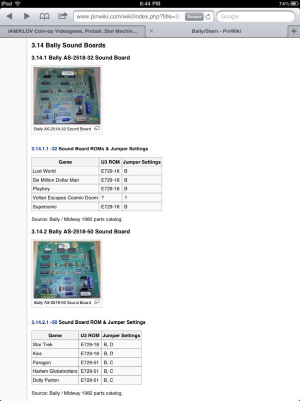

Will the sound board from Bally's Star Trek work in Supersonic. I did a pinwiki search, and it looks like Star Trek was the next version after SuperSonic, but I am not sure if that matters...
Generally a 32 & 50 sound board will interchange. There will be a small difference in tones between the two but most people can't tell the difference. Short answer - Yes.
