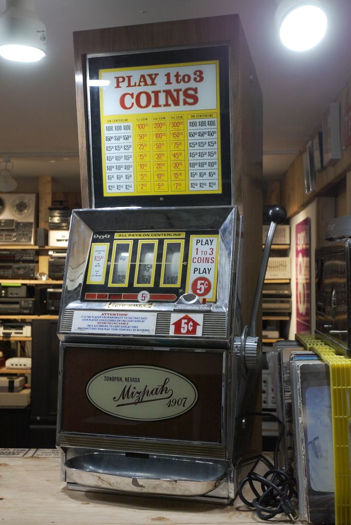

There was a 742A-192 machine not too far away from me that I decided to take a gamble (pun) on and buy from photos alone. The photos I received showed the exterior of the cabinet only. Included keys, all components, it "turned on and the lights worked" spare bulbs and a roll of nickels. Apparently it saw life at the Mitspah Hotel and the maintenance card indicated it was worked on as late as April 1982. A book of matches was found jammed in one of the door hinges. It ended up here about 20 years ago when it was inherited along with other belongings from someone who lived in Reno. The new owner was downsizing and was looking to find a good new owner for it.
http://i11.photobucket.com/albums/a166/ballsandy/New Bucket/Slot Machine/CGS_7952.jpg
http://i11.photobucket.com/albums/a166/ballsandy/New Bucket/Slot Machine/CGS_7979.jpg

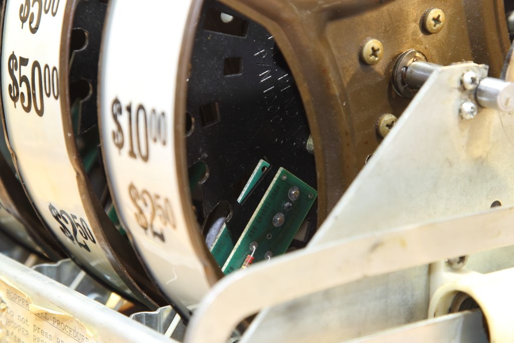

I walked into this expecting it to be electromechanical and was told that it "used to work, but one day while the kids were playing it the reels stopped locking" and expecting it to be frozen grease. No it seems this machine has a microcontroller running the show.

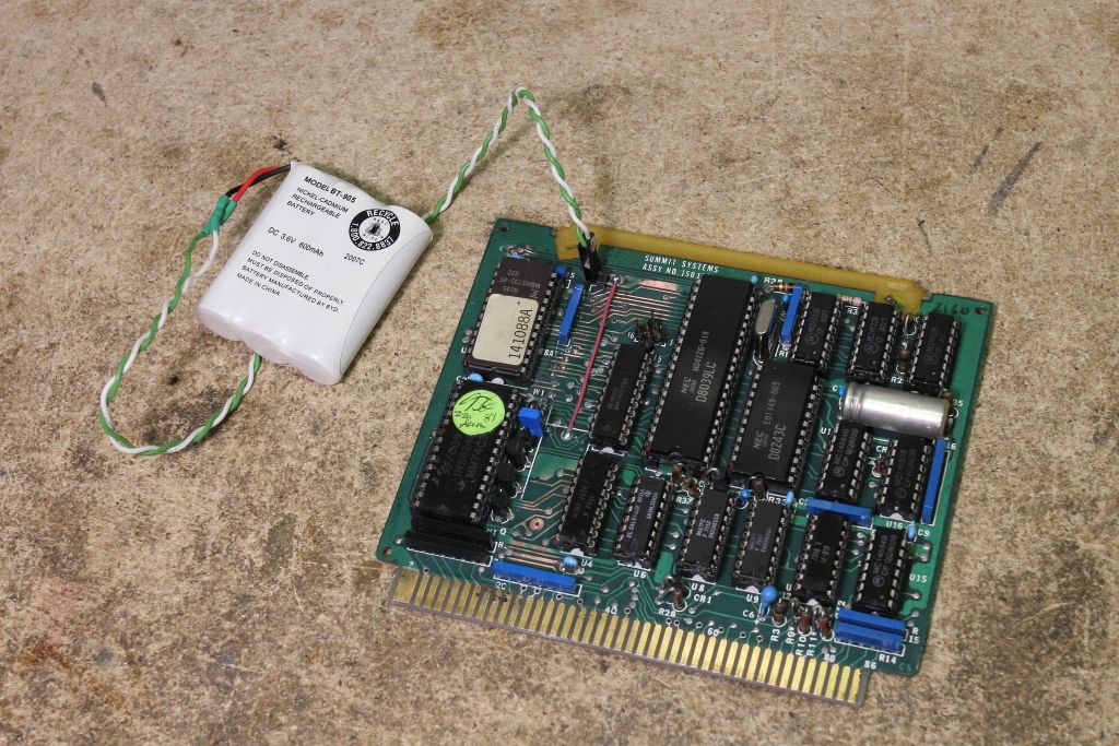

There was a badly leaking battery on the main control board. Everything cleaned up okay in the ultrasonic bath but I was not prepared to work on this. Is there any documentation for this arrangement? There was no indication of voltage on the old cell. Does anyone know what a substitute might be?

The board had to be almost completely stripped to clean out the remaining battery residue. Along the way there was one bad trace discovered and Q1 (MPS3646 transistor) was found to be bad. Don't have a replacement yet as I am unsure of a modern substitute.
http://i11.photobucket.com/albums/a166/ballsandy/New Bucket/Slot Machine/CGS_7980.jpg
I also took the chance to replace the godawful side wiping sockets that I know and hate well from Commodore's machines.
Also apparently you can get away with using a rechargeable 3.6v pack from a cordless phone as a replacement battery.

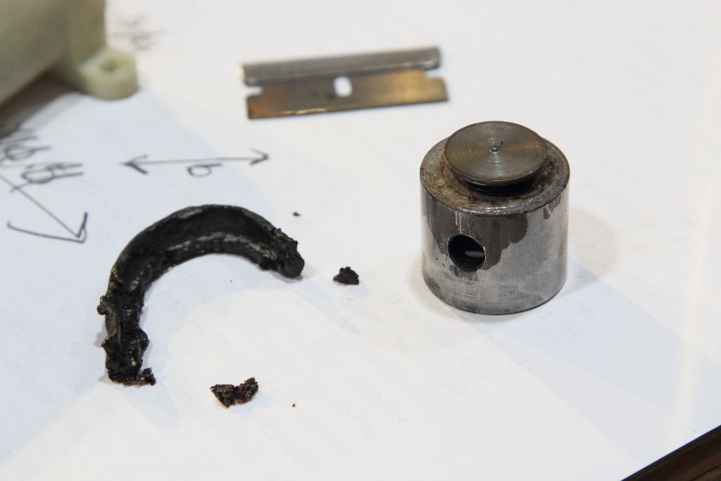

Also reassembled the air cylinder after carefully removing the old rubber seal and reinstalling the piston with the heaviest grease I could get my hands on.

Replaced transistor on speculation that a 2N3904 should be close enough to the original spec. If that fails a 2N2222 should also work.
The battery has been substituted with a 3.6V rechargeable pack from a cordless phone. I'm seeing this done to other boards and should be sufficient. Did not stop the freaking out though. :(

When poking at it with the scope it became immediately obvious that some of the data lines to the EPROM were either too weak to give valid data or completely missing. I went back over and discovered roughly a dozen of the through-hole vias measured good continuity side to side but if I tested at the traces they were open. I had to put the board under a bright light and look with the loupe to find the joints where the trace connects to the via was either about to break or broken open. After repairing those I put the board back in the machine and it came right up and worked on the first play.
Now that it works I can keep a copy of the EPROM for safekeeping and the new battery pack is secured to the side of the reels with a piece of velcro where it can't leak and cause problems again.

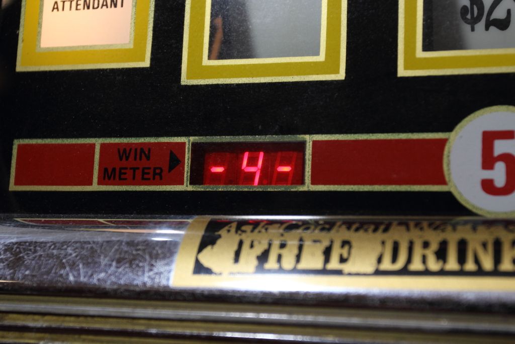

2) For the first five minutes or so after I turn the machine on I get games interrupted by tilt code -4- after the first or second reel indexes and locks. It's non-existant according to the documentation, but *4- (where * represents one of the three reels) does and indicates that while indexing a reel spun backwards.

I pulled the reel and hopper assemblies and cleaned all the contacts. This has seemingly not only resolved the issue with the display not working correctly but for some reason both the electronic and ram resident meters have started working. Likewise the payout odds have sharply improved, so I'm riding on a hunch that odds are at least in part being generated using the meters.

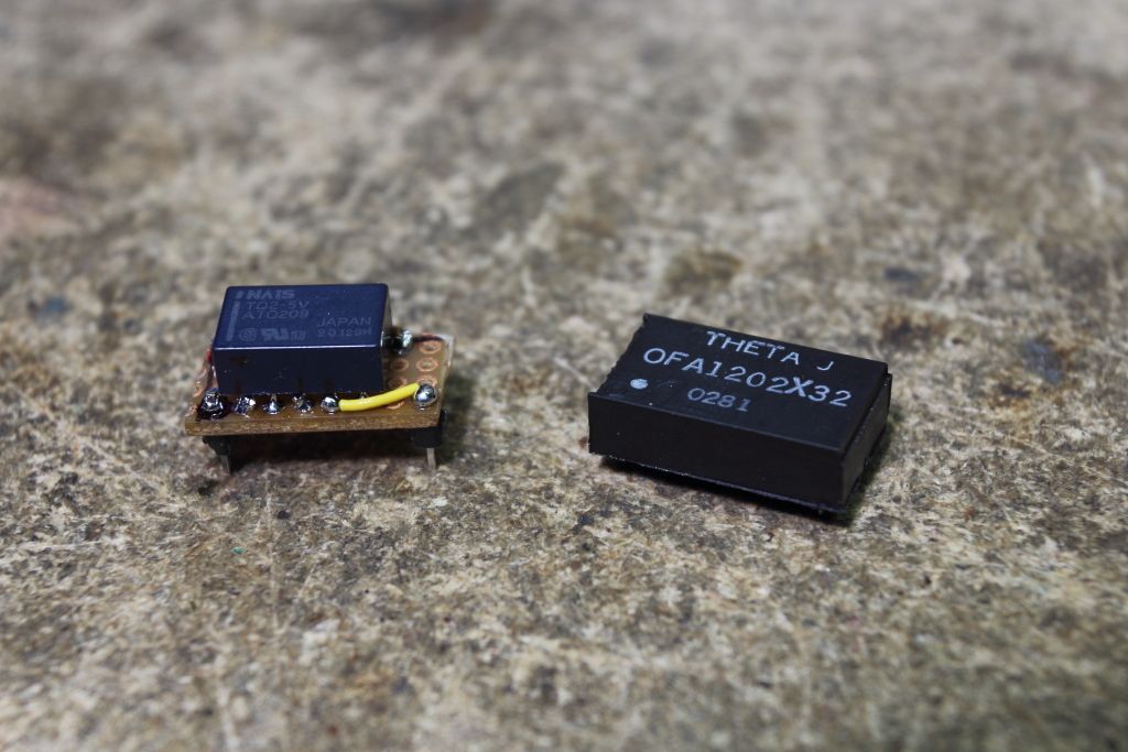

I also burnished the bulb for the tilt lamp to no avail and then proceeded to track the wiring back to where the fault was. The wiring eventually terminates at K14 on the Slot Interface Board.
http://i11.photobucket.com/albums/a166/ballsandy/New Bucket/Slot Machine/CGS_7975.jpg
http://i11.photobucket.com/albums/a166/ballsandy/New Bucket/Slot Machine/CGS_7976.jpg

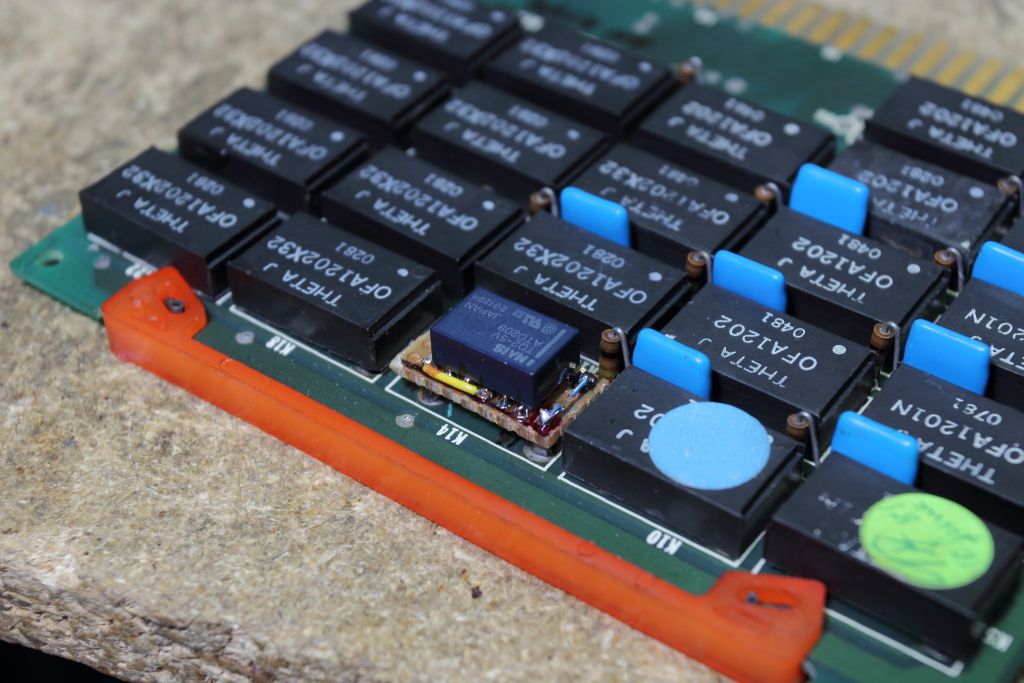

This board is not like the other boards I can find depicted on the internet. This version uses the now discontinued OFA1202 solid state relay.
I traced the control side of the relay back to the CPU where it terminates on pin 3 of U6. I was able to easily see if it was changing signal states by making the machine tilt, and it was, so the relay was now suspect. Thankfully the interface board uses nothing but the same model solid-state relay so a simple location swap and the tilt light came back, confirming that at the relay was bad. I will have to do some research on what a suitable replacement might be.
Relay issue was resolved.
After discussing the situation, load and the control input it was determined that we should be okay to substitute the OFA1202 with a mechanical TQ2-5V and diode for a flywheel on this particular circuit. The contact rating is 1A which should be okay for the load of a bulb in the front and the candle. The relay is a double pole so they were bridged together. The relay can be made to be a drop-in replacement with a bit of perfboard.

The system ran fine for the rest of the month and then this morning it began throwing those undocumented -4- tilt errors. Those could be cleared with a reset but now I got a -5- tilt code. This is not clearing with a reset. It too is also undocumented.
For reference:
-0- INTERNAL COIN COUNT METERS ERASED CHECK NICAD BATTERY AND/OR POWER SUPPLY
-1- COIN-IN JAM, SELF CLEARED CHECK COIN PATH, THEN PUSH HOPPER RESET AND CONTINUE
-2- COIN-IN SWITCH JAM CLEAR JAM, CHECK COIN PATH, THEN CONTINUE
X3- REEL X SPINNIN SLOW PULL HANDLE FOR REPLAY, NOTIFY MAINTENANCE IF EXCESSIVE REPEATS
X4- REEL X SPINNING BACKWARD
X5- CANNOT READ REEL X WHILE SPINNING
X6- REEL X FAILED TO STOP
X7- REEL X OVER SPEED
X-Y REEL X INDEXED EARLY BY Y STOPS PULL HANDLE FOR REPLAY, NOTIFY MAINTENANCE IF EXCESSIVE REPEATS
X-Y REEL X INDEXED LATE BY Y STOPS
-8- COIN-OUT SWITCH JAM CLEAR JAM, CHECK COIN PATH, HOPPER RST, PAYOUT CONTINUES WHEN DOOR CLOSES
-9- COIN-OUT JAM, SELF CLEARED CHECK COIN PATH, PUSH HOPPER RESET, PAYOUT CONTINUES WHEN DOOR CLOSES
--- EXTRA COINS PAID OUT NOTIFY MAINTENANCE, PUSH MASTER RESET TO RETURN GAME TO PLAY
--_ FREE HANDLE PULL, SELF CLEARED CHECK HANDLE RELEASE AND/OR HANDLE MECH, NOTIFY MAINTENANCE
