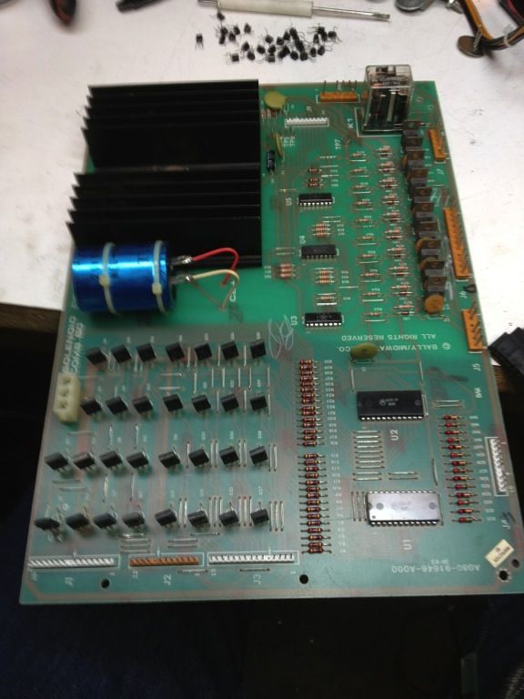

The wife says, "Hey let's take Baby pac to the 2012 NW Pinball and Arcade Show." So, I am getting Baby Pac ready and it has dead feature lamps again. Non-working feature lamps is on my top 5 list for things that piss me off.
Baby Pac's are notorious for having non-working feature lamps because Bally used a 2N5060 to drive 2 lamps each. They should have used MCR106-1's like they did in other pinball machines.
I just upgraded all 30 transistors to MCR106-6's with ease. The legs are not in the same order as the 2N5060, but they are long enough to reach without touching.

NICE! I replaced the 5060s often while tracking down bad diodes. Eventually I just started clipping them and soldering new ones onto the dead ones clipped legs.
I have a bunch of 5061 I want to try and see if they hold up better. Its a little beefier than the 5060. Still rated at 800ma but is 60v instead of 30v. Life expectancy probably wont be much different than the 5060 but I got a great deal on a batch of them so I figured I would try them. I have a ton of Bally lamp driver bds to go through.

I know each SCR corresponds to 2 lamps on the playfield. I'm noticing a pattern with my Baby Pac's issues. For each SCR, one of their bulbs is out, while the other one works. Any idea what the possible culprit might be? Is it the SCR, or could it be something else.
I've already checked the diodes and sockets for each lamp and they all tested ok. I'm wondering if the SCR is the issue or if it could be the connector.

The feature lamps in Baby Pac are driven off a center-tapped AC source from the transformer. There are two purple wires that come off the transformer to a connector. On the other side of that connector is a blue wire (0A) and a grey wire (0B). Each one of those goes through a 10A fuse on the playfield and then to the playfield lights. The 0A blue wire feed lights the Fruits "U", right inside lane, tunnel first "N", right spinner arrow, etc. The 0B grey wire feed lights the Fruits "F", fruits "T", tunnel "T", tunnel "E", etc. These alternate with the AC feed. If all the lamps on say the 0A side are working and none of the lamps on the 0B side are working then you have to suspect the fuse connected between the grey wires (middle fuse in the photo).
As for upgrading, I personally am not a fan unless a lamp driver blows. Bally used a combination of MCR-106s and 2N5060s on their lamp driver boards in their standard pinball machines, usually hooking single lamps to the 2N5060 and felt they could get away with using the 2N5060s in Baby Pac because technically it never drives two lamps simultaneously. I've never had an issue with my Baby Pac lamps and believe all the lamp SCRs are original to the machine. But if I ever have a 2N5060 blow I would replace it with a MCR-106.
If you want to test the SCRs in circuit the procedure can be found on Pinwiki:
http://www.pinwiki.com/wiki/index.php?title=Bally/Stern#Testing_Lamp_Driver_SCRs

2N5060's can be tested on board using diode function of your meter. The whole reason for this upgrade is that 2N5060's cannot reliably drive 2 lamps. Bally knew this and used them anyway. MCR106's can reliably drive 2 lamps. Another valid option is to replace all lamps with LEDs. Dok
