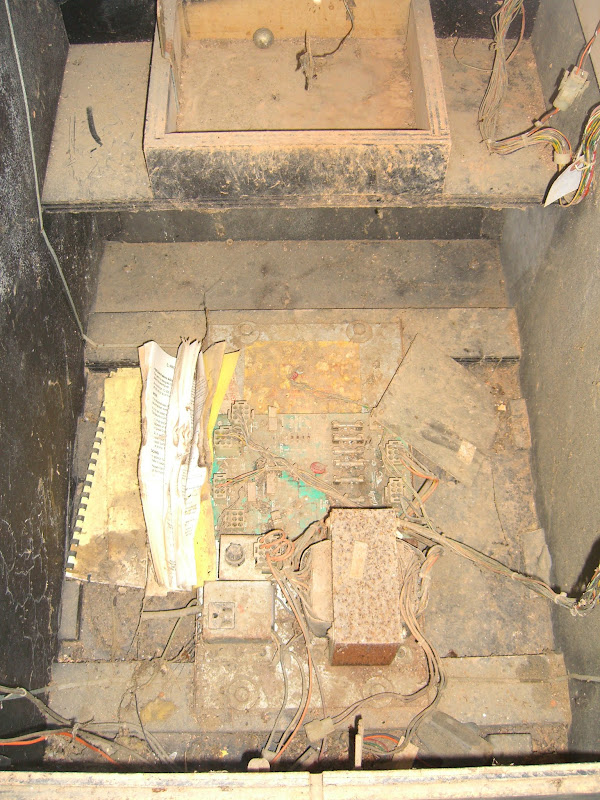

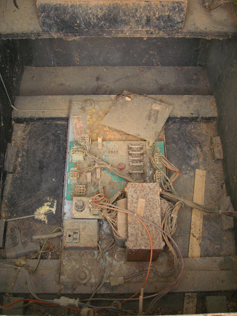

The first order of business was to get the interior of the cabinet cleaned up, as well as the transformer assembly.
I removed the transformer assembly, vacuumed out the cabinet and then scrubbed it down with Simple Green and water.

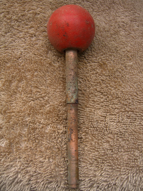

I found the original joystick shaft under the transformer assembly, as well as a quarter from 1981.
The rectifier board was caked with filth:
I decided to try putting it in the dishwasher, as many other people have done with PCBs. I didn't use any soap and skipped the drying cycle. Unfortunately this didn't work out that great for me. The board came out only marginally cleaner, but the PCB mask had peeled away in several places.

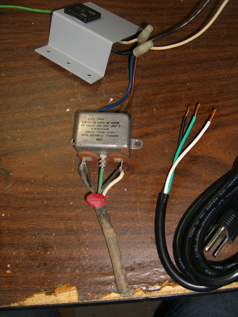

I installed a new power cord to replace the one that had been inexplicably hacked off.

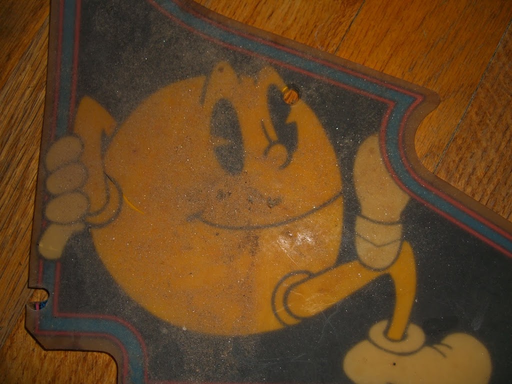

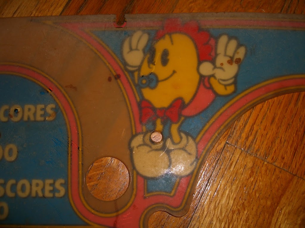

The first thing I did is clean all the plastics with Novus 2 and 1. They cleaned up really well. I was especially happy with the U-shaped portion in the middle of the top playfield plastic, which is now perfectly clear. Unfortunately the Ms. Pac plastic is missing a small piece, but I can live with it until a replacement turns up.
Before:
After:
