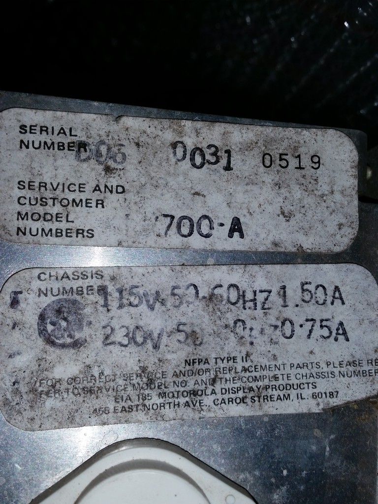

Does anyone have any information on this particular monitor? For the model number all I can see is the 700-A. It looks like it might be 1K700-A But I have no Idea. The monitor tubes ID sticker is gone so that's not going to be any help.
Part number on the frame

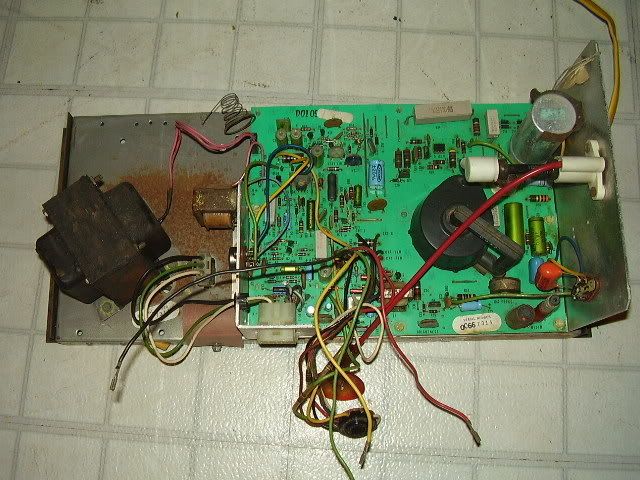

I did a Space Invaders monitor last year. I thought it was an M5000, but it was actually a KV700A.
luckily the caps I ordered assuming an M5000 were identical.
for all I know though they're the exact same thing anyway.
P6300069.jpg~original
KV700 is a Motorola chassis number for the M5000/M7000 series.
Remember, if the tube is 19" then the model is M5000. If the tube is 23" then it's a M7000.

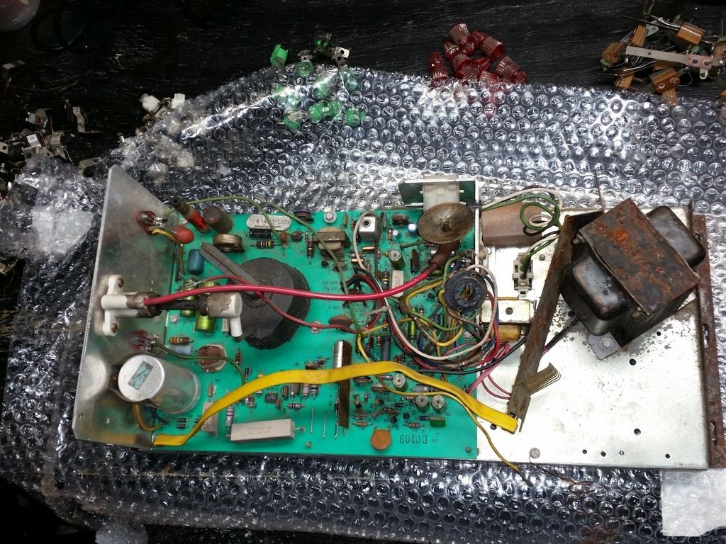

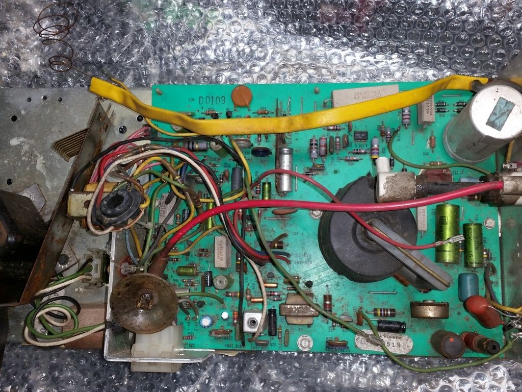

ok so I was technically right then. :) both my SIs have the Wells chassis.
I sourced my caps from mouser. if you google around for an M5000 cap list you should find it easy. that SI monitor I capped was turning white, you couldn't adjust brightness on it anymore. it wound up looking amazing after I capped it and adjusted everything properly.
