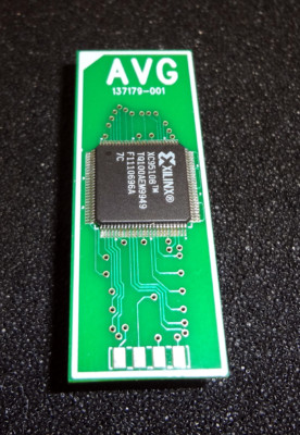

Does anyone have one of these? My Star Wars can likely use an AVG chip replacement. I am not sure which ones are best to get, and I am open to get one from a member here if you have one for sale. Thanks so much.
To be sure, remove the one from your Black Widow and test in the SW. :unsure:
That said, however, it's always good to have spare AVG and POKEYs in your parts bin.
The BEST AVGs were made by Biltronix. Too bad he's not around anymore.
Needless, the archive of his site still details his comparison of various repro AVG solutions.
A good read. Recommended.
The ones on ebay are fine (from user pm-sam). They are the ones I use on all boards, as I replace them on all boards that cross my bench.
I also know the guy who makes these (since I buy so many of them), and he's a very smart guy who knows his stuff.
If there aren't any current listings available, just message him. He has more.
There's really little value in trying to test an AVG chip. (And definitely never test one in a working game. At best you should use a scope as a display, not an actual monitor.) If it's an original chip, you should always just replace them. It's the best $20 insurance you can give your vector monitor.
When they go bad, they usually go REALLY bad, and are so messed up they just cause the board to output junk, railing the XY voltages to maximum (which can easily blow your monitor). So by swapping parts around to try to 'test' one, you'll end up with two blown monitors instead of one. This is why you never want to troubleshoot vector problems by swapping boards between cabs. Always use a scope and/or DMM.

I bought a batch from Bill. I did not ask, nor did I get any discount. So while buying directly from Bill, you could have got them for $25 plus shipping (per info in post above), my net cost is more, as I also had to pay shipping, and then I would be charging you shipping too. I did not buy these with the intent to resell, I wanted to get a "lifetime supply" for me and not have to worry about finding them again.
After buying from Bill, the ebay seller pm-sam also made an AVG repro and I sold them here on KLOV for $16. I sold several hundred of these for him here. I think they work excellently, and in all the ones I sold, never had a single return.
I'm not twisting anyone's arms to buy from me, and if you want to price police me for making a few bucks, I'm not offended. Go ahead and buy them cheaper from Bill or on ebay (paying taxes too).
For Bill's, offering at $35 plus shipping. for pm-sam's version still offering at $16. I have them in stock right now and can ship within 1 business day. (FYI, if you look up my AVG FS thread, PLEASE DO NOT PAY TO THE PAYPAL LISTED THERE. It is inactive).
Figure $6 shipping for 1-4 (within the USA).
