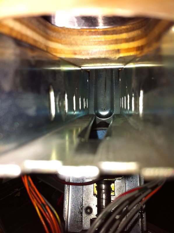

So I've only had my AFM for a few days, and am certainly no expert on it yet, but the regular multi ball should be a 3 ball multi ball, right? The last locked ball comes down the ramp, and the launch lane kicks a ball onto the playfield automatically, but then that's it, just two balls. Then when I lose one, regular play resumes. I don't get any errors when I fire it up, and I didn't seem to come across any settings that allow you to change the # of balls in play, but it plays as if 2 ball is just the way it is. Does anyone know how to correct this, or is it really a 2 ball multi ball?
I'm 99.9% sure your ball trough has divots.. As mine did, so did my TZ, and MM.. Pull it out and file down the divots.. Balls can't roll correctly cause of it.. Or buy the $125 upgraded one.. Using a file is cheaper :)
Here's a pic I just snapped of the trough, and it looks and feels pretty divot-less to me. Any other reason why the third ball won't come into play?
Balls magnetized and not rolling down the trough good.
