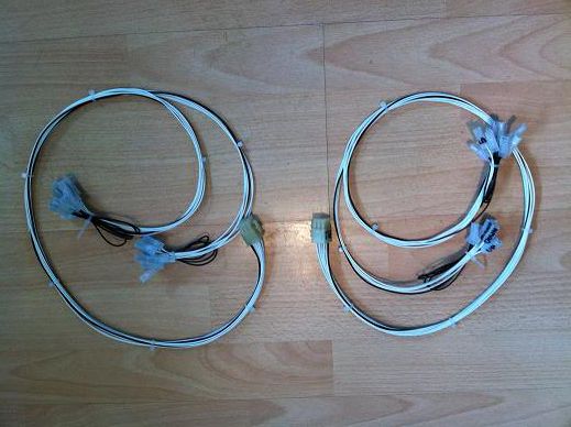

First, I had Franco B on Forum.arcadecontrols.com construct me the cabling I would need. After pinning out what the joysticks and buttons would be he figured out the connector I needed was a universal mini mate n lock 12 pin connector.
Here are the cables he built:

Looks very good. How much did Franco B charge to make the cables and do you have his email? If you could shoot me a PM with the info. I've been wanting to do this to my sports shooting cabinet but hadn't bothered trying to track down what it would take to make the adapters.
I'm surprised how hard it is to find original control panels for that cabinet.
Couldn't you have bought the original atomiswave jamma wiring?
Granted that would only be a 5 button layout.
One would have to find the wiring adapter. They are not that easy to find, same goes for the control panel which is why he had to build his own.
