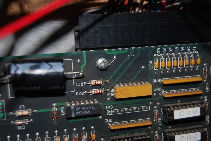

After a week of pm's, e-mails, pics and testing, I've answered the Ataxx trackball enigma.
There are multiple versions of the board, those with and those without sound pots. There are NOT trackball/joystick versions.
PALs at locations U75, 76, 77 & 78 must be labeled as pictured in order for trackball control. The JAMMA adapter simply converts the edge connector to JAMMA pinout and handles video, it does NOT convert a board with trackball PALs to joystick or vice versa.
Now you know, and as G.I. Joe has taught us, that's half the battle.
U78: 02-11-01
U77: 02-10-01
U76: 02-09-01
U75: 02-08-01

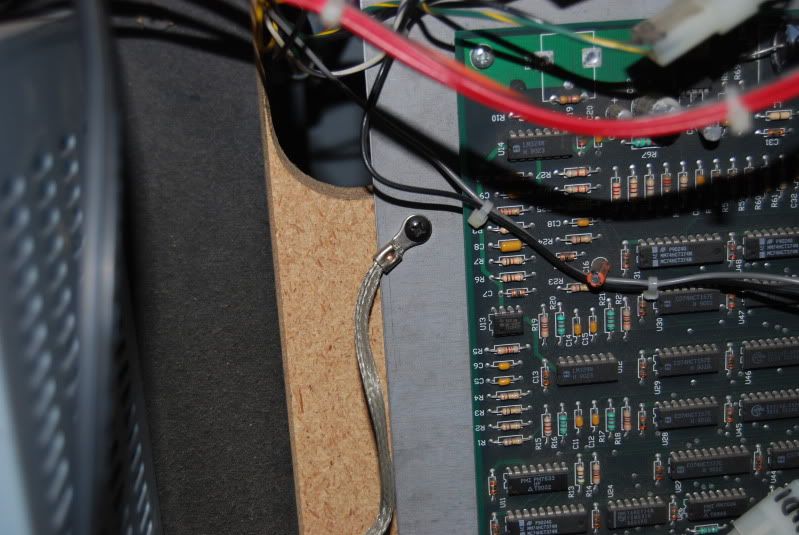

Along with the "trackball" pal's, be sure to install the PCB with all the screws to the metal plate. Apparently, it creates the ground for the trackball controls.
I was testing my "trackball" pal board out of the cabinet. I had intermittent vertical tb movement and zero horizontal movement. After tracing the wires back to the harness, I figured the common problem would be the ground. I am not an expert, but the ground traces seem to go nowhere on the board from the harness!. I did notice on the "Trackball" pal board, there is a jumper soldered from the ground to the screw hole. I mounted the board to the plate and the trackballs worked perfectly!
THis is the Trackball pal PCB:
This is the joystick pal PCB:
U78: 02-11-01
U77: 02-10-01
U76: 02-09-01
U75: 02-08-01

I am fairly certain it was the ground all along causing the issues. It didnt have track balls when I first got the machine. I had the JAMMA version in a Zback and I really wanted a dedicated. A friend found the empty cab at auction for $25 and snapped it up for me.
