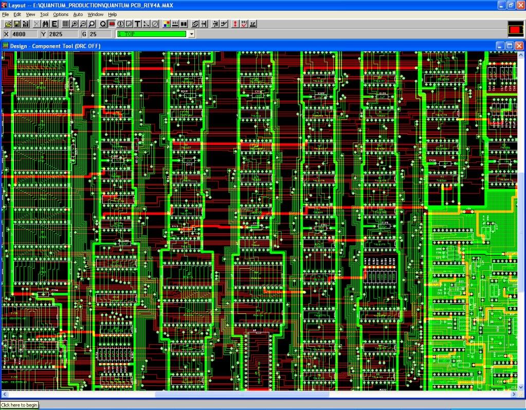

This second one is a close view of the middle of the board once I completed all the routing, showing the top layer in green and the bottom layer in red.

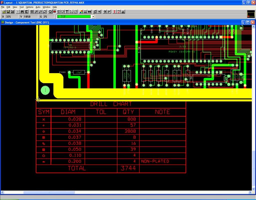

And a little bit of useless trivia, if you ever wondered how many holes you would have to drill if you were crazy enough to try your own etching (impossible since you would need plating capabilities for the through holes).
You would be at the drill press for a long time there are 3,744 holes in the Quantum PCB.
