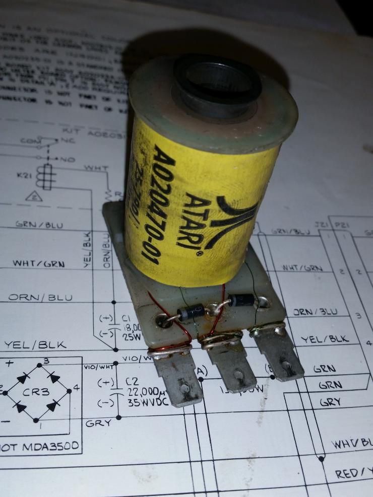

Yeah I was thinking that one was probably bad but all of what I'm guessing is the thin side of the coil measured quite high. The 160 range seems quite high to me most coils I have seen usually don't go above 50 to 60 ohms. I just need conformation with the measurements not sure how many people have Atari pins here.
Here is a picture of the only labeled flipper coil, this was the top left coil in my game.
Ah finally I found the coil values for the flippers. Looks like all but one is good.
Atari # A020470-01 (25/790) is the flipper coil. Has two diodes installed. The high current pull-in winding is 4.5 ohms dc resistance. The total resistance of the pull-in and hold windings is approximately 150 ohms. The coil has 1/4" quick connect terminals, so no soldering is needed. Uses Atari coil sleeve # 006791-01.

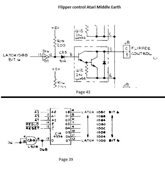

Going on that information this is what I found in the manual on Pages 39 and 43. Looks like I will have to take a look at the logic. I believe I got that right says latch bit 6 1088 and the diagram on page 39 shows 1088 latch 6. So will have to take a look at the chips at locations D16 (page 43), C14 (page 39).
I have to look at my space riders. I could swear there is a relay for the flippers. It would be very odd to directly enable the flippers from the logic alone.
Well there is a Relay on the main power brick I can see it latch on when the game is turned on and the other playfield coils reset. I was getting continuity through the wires all the way from the fuse to that relay. Tested continuity through the fuse into the PCB through the transistor up to where is goes into some resistors then into an IC which all seemed good as far as the electrical path in concerned.
