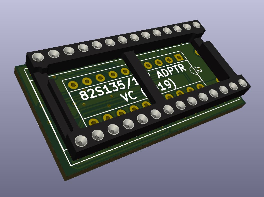

My real question is.. is that PROM adapter/pcb available? One of those would be very helpful.
That would be great. a way to read PROMs fast like that is nice..
If you want a board I can mail one out. These ones are a bit flawed because I didn't think it through. I have a couple left. They work but need a bit of modification.
Yeh, better than reversing the pins/socket on an individual PROM-to-W27C512 adapter and reading them as 512.
One board to read them all. Nice.
I made a bunch of adapters like that for the atmel 27c256 45ns otp eproms. I really should finally have these all made and tested. I was much dumber 4 years ago than I am now, so I should also check the design...

If it works after mods - I'd like one.. thanks :)
I'll PM info.
This is what we had to mod on it, just tied the upper 4 data line low. When they were floating it would return random data on those upper bits.
There other thing I found is that the files my EMP10 spit out were doubled. I had to delete lines 0400-07F0 then they verified against Romident. (I both verified them in the EMP10 and read them to have Romident doubled check)

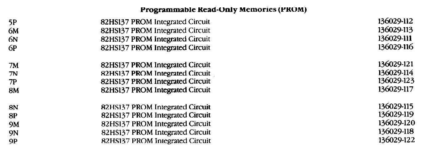

I think to clarify on this point from @bakerhillpins is that many of these PROM locations REQUIRE the higher speed TI PROMS or the B (high speed) Harris PROMs... and to @VectorCollector point, Atari spec'd high speed PROMS for ALL the locations.... I think they were all TI (Plastic) or Harris(Ceramic). What I have seen over the years is that when PROM's have died, previous repairs over the years have thrown in the lower speed PROM's because folks were mostly looking a capacity+configuration vs specifically the speeds because it is a bit of a rabbit hole finding the speed suffix information (especially for aformentioned Harris because they changed their speed labeling through the early 80s)... So, I guess my actual point is that you can't necessarily go with replacing what is there because it may not be original and may have been replaced with an out of spec PROM... the lower speed PROMs *will work* in some locations but I expect by doing that, it is probably working your PCB set closer to a 'You have hit a black hole' message.

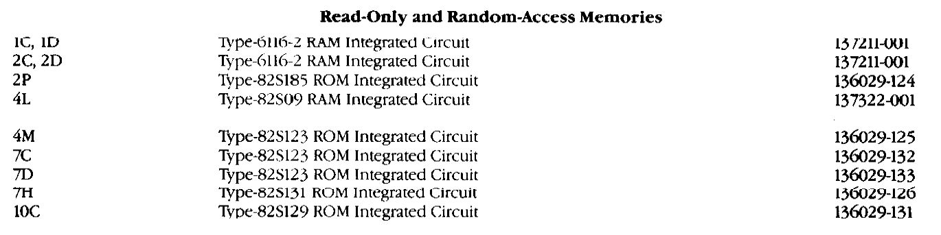

As I showed above from the I,Robot manual/BOM, Atari did indeed specify 82HS "high speed" parts for the CPU board and typical 82S for the VID.
So, I assume the dependency on speedy bipolars only relates to the CPU board.
I must admit this is the first time I've seen 82HS137 instead of 82S137.
There are only three KLOV threads mentioning the HS part. Which is fascinating.
The most relevant thread being this one from 2012 ->
Which implies I,Robot is unique to needing the faster PROMs.
And perhaps the A version of the S would work as well. YMMV
82S137 - 60ns max access time
82S137A - 45ns max access time
82HS137 - 45ns max access time
82HS137A - 35ns max access time
