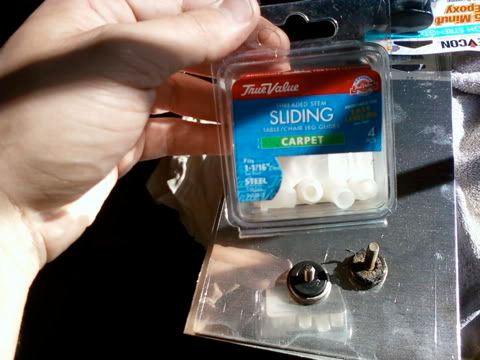

Are the small Atari cocktail table leg levelers available?
If not, is there a preferred replacement part?
And the small metal rectangular pieces on the bottom of the legs - do these need to be replaced also, or will new levelers fit without them?

I just found a set at True Value hardware that were a perfect fit. The steel pads that contact the floor were slightly larger in diameter, but otherwise they were a nice drop in replacement. I agree, most stuff you find is 1/4 - 20 but the proper fitting stuff is out there.
I'm fascinated. Do you have a True Value part #?, or pic of the package? I've gone with 1/4-20 and a tap, but any crumb you can leave for the next guy will certainly help.
Ok, here are some pics:

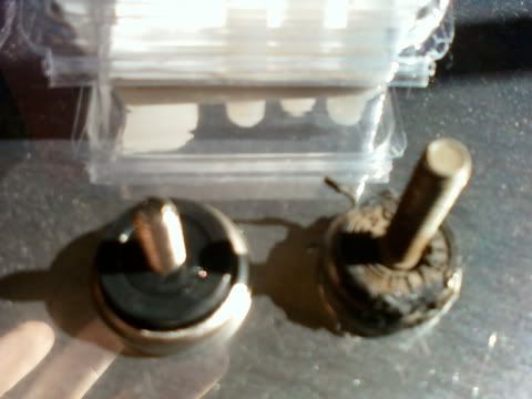

The replacement is on the left. It may look like the threaded rod diameter is smaller, but that's an illusion--these are an exact fit. Notice that the new one has a shorter threaded section, but it doesn't matter when installed.
Here is the packaging (minus the feet). They came with plastic inserts (shown) which I did not use. I will try to post the part number later.
