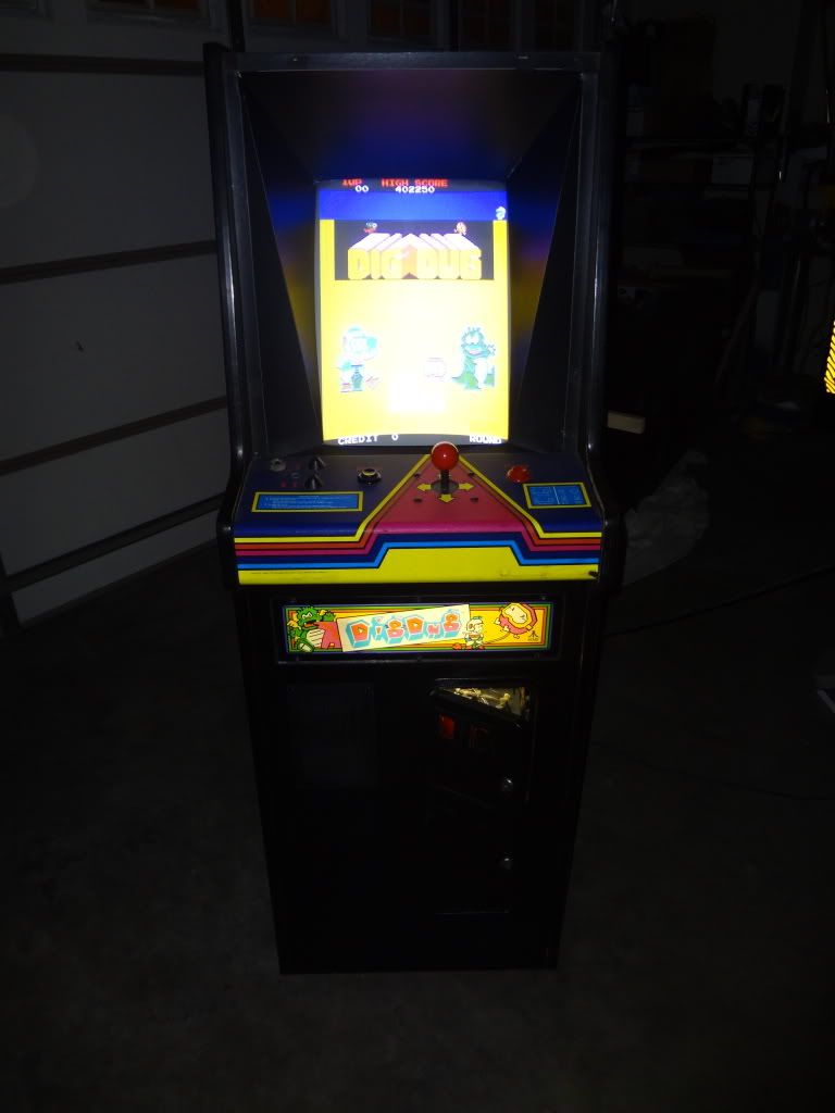

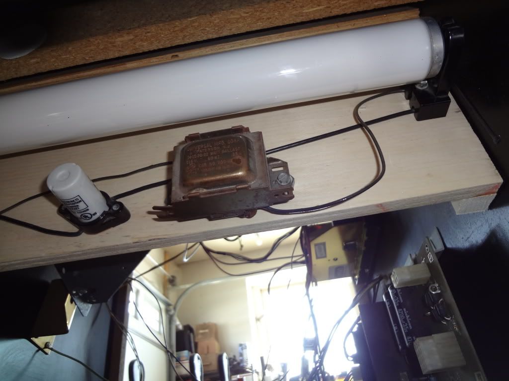

Finally fabbed and installed my Atari marquee light for my Dig Dug mini this past weekend. I used well-worn parts from old arcade florescent light assemblies to make it look more authentic (a store-bought fixture just looked too white and shiny), a new FS-2 starter, a piece of 1/2 inch plywood (should have stained/aged it a little, it looks a little too nice) and 2 small 3/4 inch square dowels. I mounted the assembly directly below the bezel mounting blocks, to make sure it sat back far enough to allow cp latch access thru the coin door:

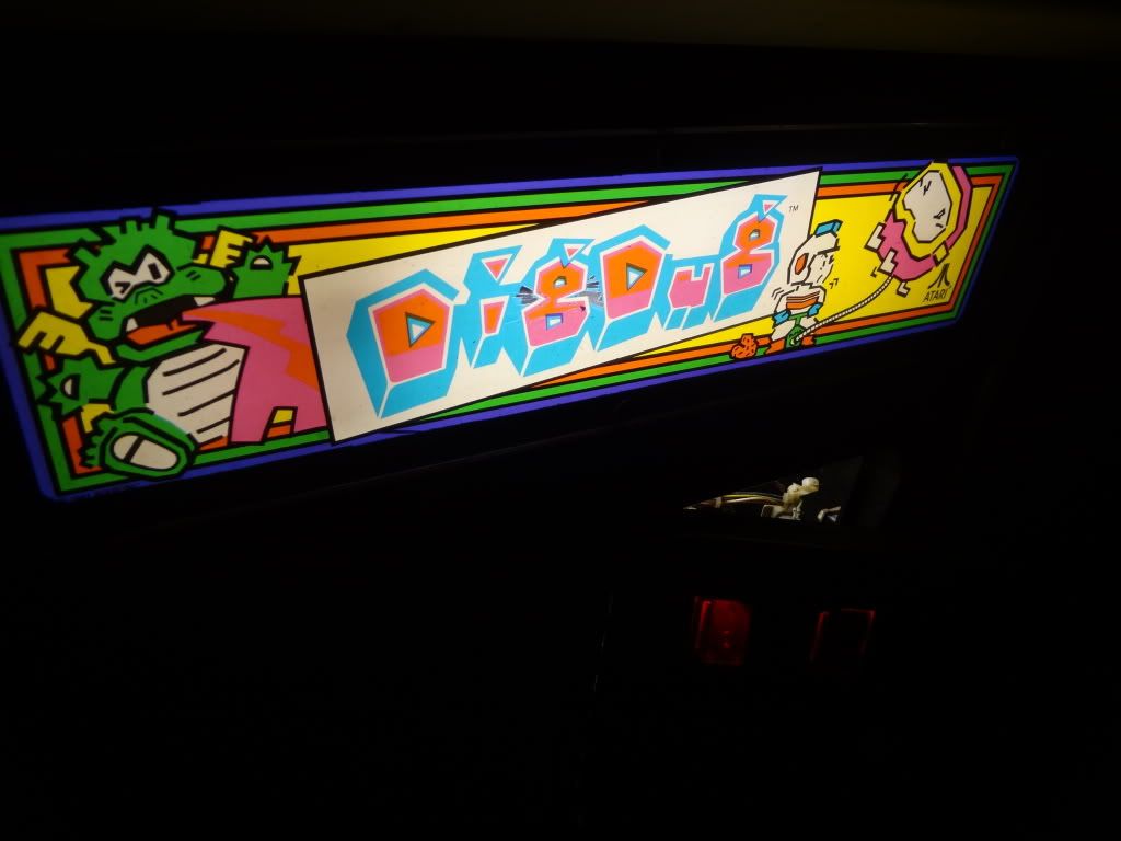

And it works well:
Finally fabbed and installed my Atari marquee light for my Dig Dug mini this past weekend. I used weel-worn parts from old arcade florescent light assemblies to make it look more authentic (a store-bought fixture just looked too white and shiny), a new FS-2 starter, a piece of 1/2 inch plywood and 2 small 3/4 inch square dowels. I mounted the assembly directly below the bezel mounting blocks, to make sure it sat back far enough to allow cp latch access thru the coin door:

Yeah, it makes a big difference.

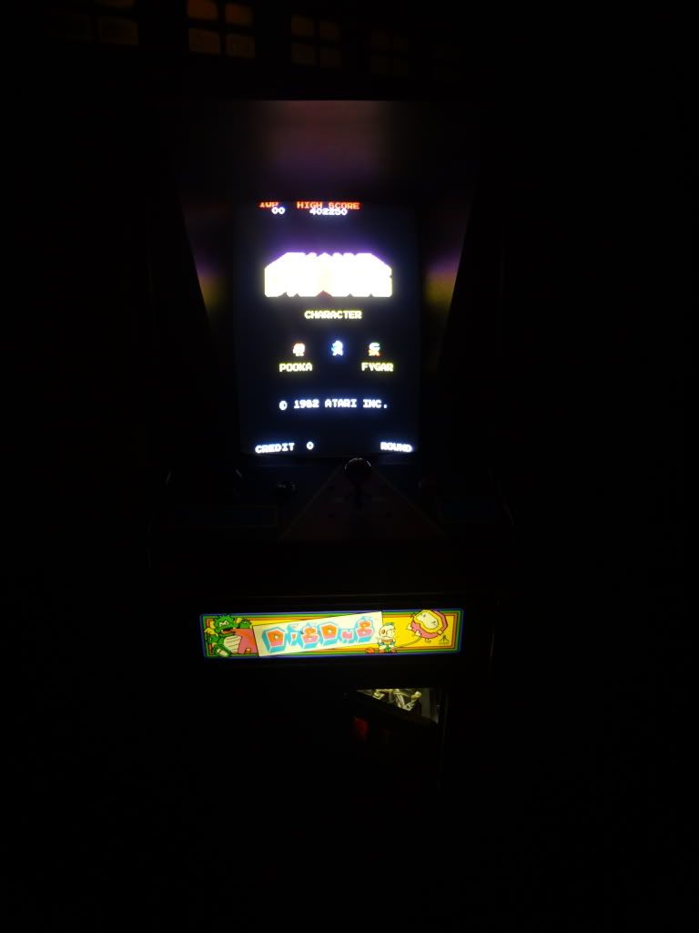

Before:
After:
So Dig Dug cabaret didn't have marquee lights originally?
Dig Dug and Centipede cabarets, no. But they put it in the Tempest cabaret for some reason. Maybe because the poor Tempest didn't get an bezel art. :D
