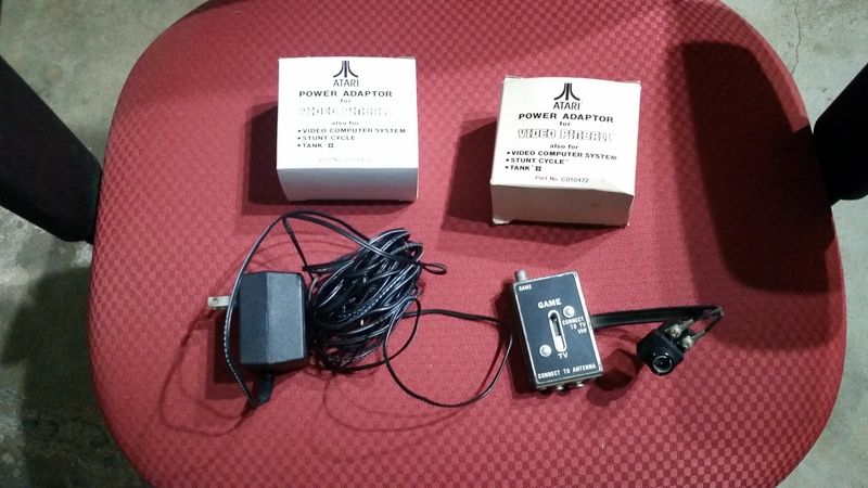

Just dug out my childhood 2600, from my parents attic. I knew it had been kept, and had seen it about 10 years ago, with the intent of re-taking ownership of it one day. The day finally came. Holy crud, what a treasure trove. The first issue seems to be the mangled wires on the RF adapter. Soldering iron is warming up. Can't begin to see what else is and isn't working until that is repaired and it's hooked up to a TV.
Okay, got the RF adapter repaired. My digital TV of course wants to scan for channels, and does not find any channels, with the atari hooked up to the RF input. I checked the power supply, and it is labeled 9V, but is putting out 13.5V. I pulled out the other power supply, which is an original Atari power supply, and it is putting out 15.5V.
Are those voltage ranges normal, and have I potentially fried my Atari before even getting it to work again?
:edit: Problem solved with a CRT TV. The 2600 is apparently pretty resilient, and while rated for 5V-12V, minimum of 500mA, can handle up to 35V and as little as 200ma....although overvolting to upper range and providing less than spec'ed current isn't best practice.
