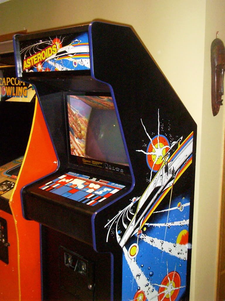

Nice work, glad I don't have that much to do on mine :)
Just repainted and put on a new cpo this weekend, feels like a new machine.
Noticed that TNT Amusements puts chrome t-molding on theirs they sell, looks nice as well imo.
