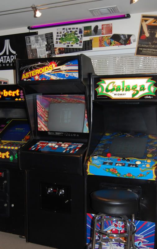

Hey guys, thought I would share some pictures of my latest project.

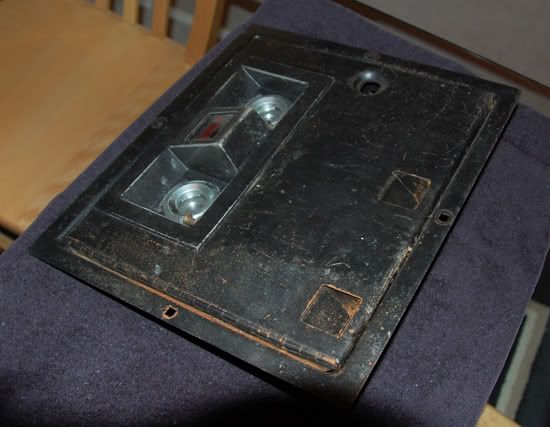

I have wanted an Asteroids with an owl eye coin door for a really long time. They are pretty hard to find (for me at least) and I already have a nice Asteroids so .. I found a junker owl eye door in my stash of parts and went to work.

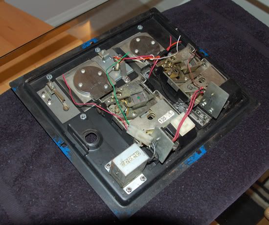

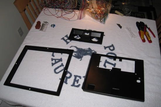

Not sure what game this door was originally from (there is some blue paint on the underside if that is a clue) but it was pretty rusty .. no major dents fortunately.

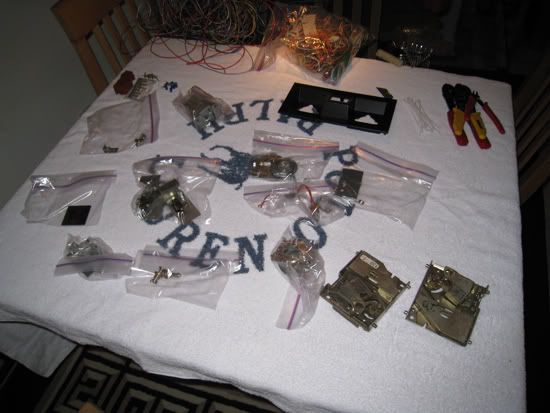

Took it apart, lightly sanded it with some 400 grit, and painted it with good old Rustoleum 7777. The texturing was a little tricky but I think I got it pretty good.
Time for reassembly! Everything in little baggies to keep it organized. Apparently, there is a five image limit so more to come in a second post .. stay tuned!

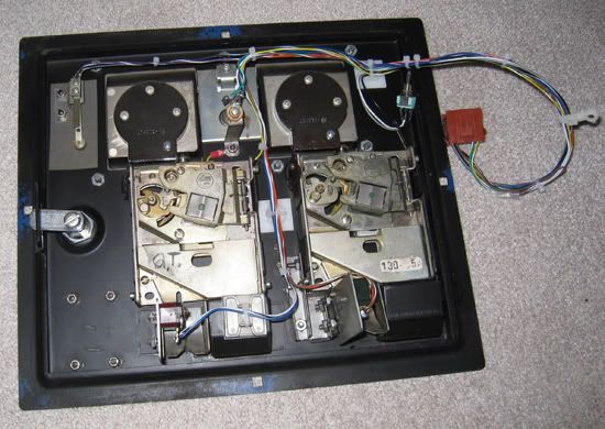

All cleaned up, reassembled, and lookin good.
Had to build a custom wiring harness. Fortunately Bob Roberts had the right connector.

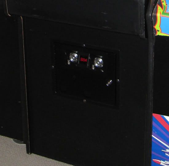

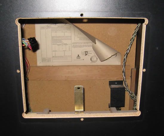

I expected the owl eye frame to just drop right in but I was wrong. There was a slight clearance issue so I had to route the edges of the door opening 1/8". I also had to move the door interlock switch back a little.
All installed and looking sharp! Some purists will probably hate this but I think it looks great! And I can re-install the old original door if I want to so it isn't a permanent mod.
That door looks awesome!!! WOW Bravo!!! was the connector different on the harness? Did you have to make a adapter??

djw90 - The connector is an Amp 24 position. Bob Roberts sells them (M/F pair with pins/sockets).
I think this door came out of a Subs because that is the only game I found in the KLOV DB with an owl eye door that was painted blue. Below is a picture of the full game. I really like the chrome eyes, they are an attention grabber. Now I just need a Defender with a nice stainless steel door and I will be all set!

did the bolt holes line up ok for the coin door??

Yup the bolt holes lined up perfect.
