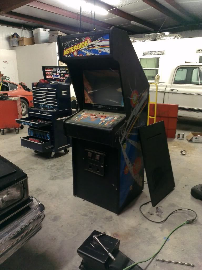

Brought home a machine tonight. It worked years ago, but has been sitting on a shelf for about a decade. It was put on the shelf when the monitor no longer worked.
I plug the machine in, the lights come on (coins, player 1-2 LEDs), and the speaker hums. The volume knob will control the level of the hum.
There is absolutely no video. Nothing on the screen happens at all.
I just don't know where to start.
What scares me is, even with the video out, I should be able to play the game and hear sounds, correct? The player 1&2 LEDs stay solid, which I believe indicate zero credits. I open the front door, and there is a little arm that a coin would hit. I tap it a few times, thinking it would give a credit, but the LEDs stay solid
I have two options. I can attempt to trouble shoot it myself, or take it to a place in Austin, TX called Pinballz. It's about 100 miles from me, and would obviously require 2 round trips. 400 miles adds up.
http://www.pinballzarcade.com/services/pinball-and-arcade-game-repair
I'm in a tech school studying electricity. I've had AC and DC classes. I've even built a small power supply. I know electrical components, caps, transistors, resistors. I can solder as well, but only have a little experience (basically a semesters worth building this small 2A DC power supply). I have a Fluke 77 and plenty of tools. I wouldn't mind attempting to fix this, and avoiding a hefty repair bill (remember- broke college kid), but at the same time, I maybe better off taking it to someone who knows what they're doing.
Any advice? I hope this is okay for my first post. I donated and everything. I'm really excited about this machine!
Here it is!

The machine had been off for about an hour. I walk out there, turn it on and the next glow was pretty bright and obvious. I also have a steady red LED on the upper most board, next to the monitor which I assume is the deflection board.
Neck glow - glowing
spot killer - steady red LED
The longer the machine was on, the more faint the neck glow got. After a few minutes it wasnt visible. After turning it off for 2 minutes and back on, the neck glow was visible, but very dim.

On the main board - Found a spot that said GND and one that said 5V. Assuming these are test points, I found 4.64VDC, and .8VAC.
On the board directly above the main PCB I found another GND, as well as a 5V point and a 10.3VDC
5VDC reading was 4.8VDC (.93VAC)
10.3VAC reading was 8.98VCD
Ieure When you say meter all my power supply voltages, where else other than the two 5V points, and the one 10.3V points can I check?
Ok, so you have 4.8 at your power supply and 4.6 at your main board. You need to turn the adjustment on the power supply board up so you have 5.0 to 5.15 on your main board where you now have 4.6 , be careful, it's not hard to turn it up too much and damage your main board.
Edit: Keep it simple. Start with the basics. Forget all the other stuff. First thing to always check is your +5 . Get your 4.6 up to 5 volts. If the game still does not work, Gently, and one at a time, take out your socketed chips and re-seat them. If the game still does not work, put it in test and see if you get anything. Start with that.

I put my meter on the 5V and attempted to make an adjustment. It was already at nearly the maximum. Taking the pot as high as it could go only got me 4.74 VDC. That was at it's absolute max...

You have a power supply problem. Replace your big blue and rebuild your AR2.
I went to http://www.therealbobroberts.net/parts.html#atari
Looks like big blue is $12.50. I'm not sure what AR2 means.
Is it this?
"Atari A/R II-02 to -06 Repair Kit (Caps+Q2/3/8/9+R30)"
If so there is quite a few Ar2 things. Is the "repair kit" all I need?
If so, I'll order today.
Yup, audio / regulator 2. That repair kit should do the trick.
