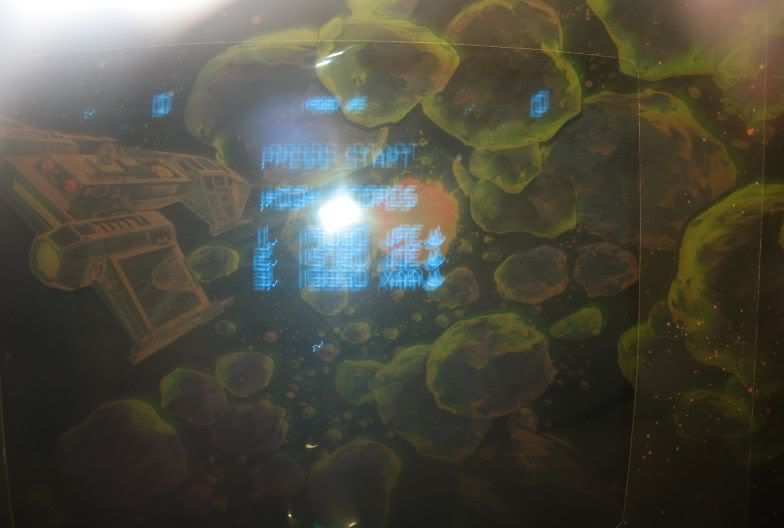

Thanks modessitt for the info and orion3311 on what starter to get . $15 and I got both lights working . I got a "warm white" bulb for the marquee but I think I could have gotten a brighter one . I also got the "white" black light bulb but haven't tried it yet . Using the "Black" black light bulb right now and it looks pretty cool ! Once its in the game room I'm gonna try switching the black light bulbs around and see which one I like better . This game is awesome !!
