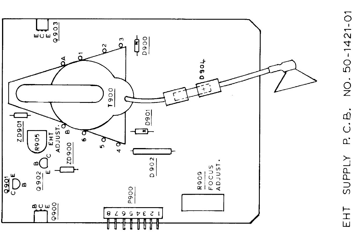

I have two different levels of brightness for the images on my AD. The ship and asteroids are fairly dim, but the "bullets" are nice and bright. Is there an adjustment on the board to brighten the dim images? I can still play fine, but it can be tough to see with black light on. By the way, the monitor has been serviced. I tried adjusting the flyback, but that is for overall brightness.
Use the brightness and contrast pots on the monitor's deflection board. Turn both to max, then back brightness off until the retrace lines disappear. Then back contrast off to taste. (I leave mine all the way up, but it's your choice.)

Having shown the above, the OP, if he owns a HV PROBE, should also validate the HV is in spec. [14.5kV +/-5% for 19"]
But ideally, the solution is to just tweak the brightness and contrast POTs.
Vector Newbs. :001_stongue: [VN]
But realistically, any CRT has a "screen and focus" type adjustment. Go fish ... R909 (on a G05 or V2000; G05 shown below).
Yeah I looked at this after reading your focus comment. Used to this adjustment being on a flyback that's obvious to spot, and not burried in a cage. :)

Took another shot at brightening the screen up. Between the two adjustment pots, took it all the way up to the draw lines and then back just enough to make them disappear. Unfortunately, as brightness increased, the less focused the images became (particularly towards the outer edges of the playfield. I tried adjusting the focus near the flyback, but could not really tell if the pot was moving. There wasn't any change and I cannot get a really good look at what is happening inside the cage. I just messed with the two pots again and went for the best compromise on brightness and focus.
Sounds like you might have an HV problem. Recap the cage and get a new diode, and you'll likely be all set. You'll also need an HV probe to calibrate the HV level, as if you haven't measured it, it could be way off. (Maybe try that first, as it might just be that.)
Also, the focus adjustments on these b/w's never seems to do much. I don't know what the deal is, but I've never had one make much of a difference, in all of the monitors I've owned.
