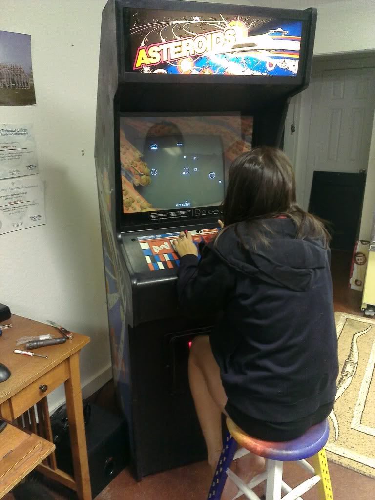

Man, that was totally it. I didnt see those caps at first because they wern't what I was used to. They were little teardrops. Got 'em soldered in, and it sure works. It's bright and crisp! I put it in test and stretched the screen to the edges as well as turned up the brightness a tiny bit. Can it be too bright and cause damage?

I got a few bulbs and a starter from Bob Roberts. Machine sure is looking wonderful now.
Now all I need is a high score save kit, and a good cleaning.
Cheers, and thank you so so much.
