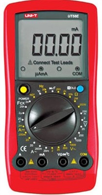

And if you need a DMM, invest in a 'good cheap' one. You don't need to spend hundreds, but you want to avoid sub-$25 meters. (Like the free ones they give away at Harbor Freight, etc).
The UNI-T UT58D or UT58E are both excellent inexpensive Chinese meters, well-suited for this hobby. I have both:
