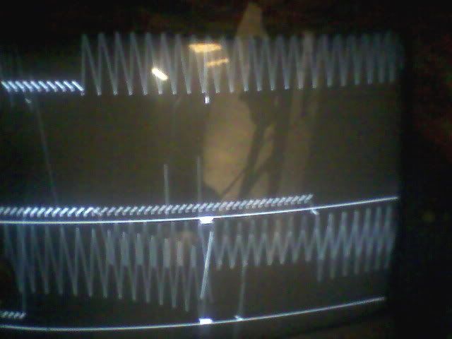

Picked up an Asteroids today for repair and it appears to be playing, but the screen is awfully funky.
Here is the gameplay screen:

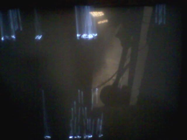

Here is the test screen:
The only beeps in test mode are when I push buttons (as expected). Can't see if an error is being given on the screen or not.
I'm guessing a problem in the X/Y section of the board?
Anyone care to point me in the right direction? DAC's? Something else? I seem to have gameplay, but the X/Y ouput is screwy...
Confirmed as a board issue. Asteroids Encyclopedia seems to indicate it is a problem in the Y-counters, so I'll start there....
This issue has been fixed.
Replaced the three 74LS191 multiplexers in the Y circuit and now have a perfect picture...
