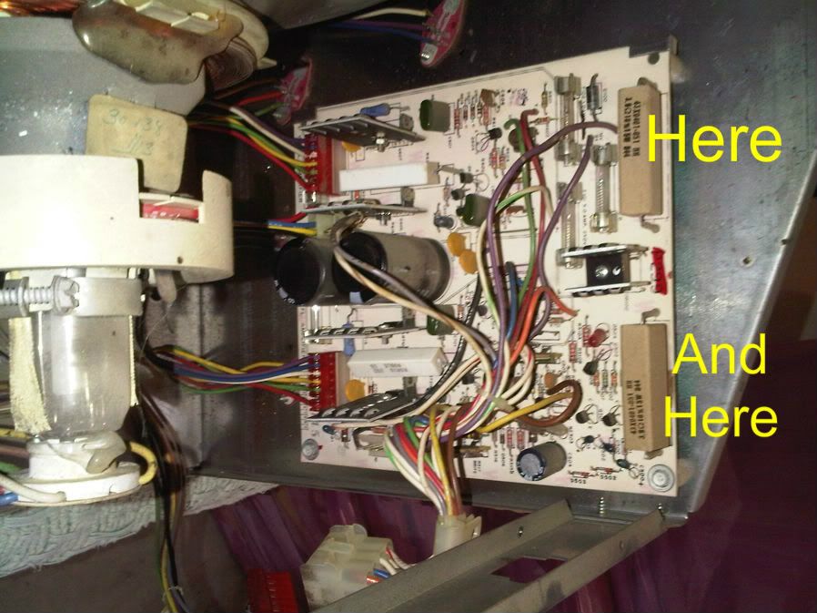

Have you checked the large sand resistors on the deflection chassis? Mine was acting just like you described, and in the end I needed to remove those resistors and jumper them.
The vector FAQ mentions removing them as an acceptable modification anyway.
On my V2000, they were near the edge of the pcb.
