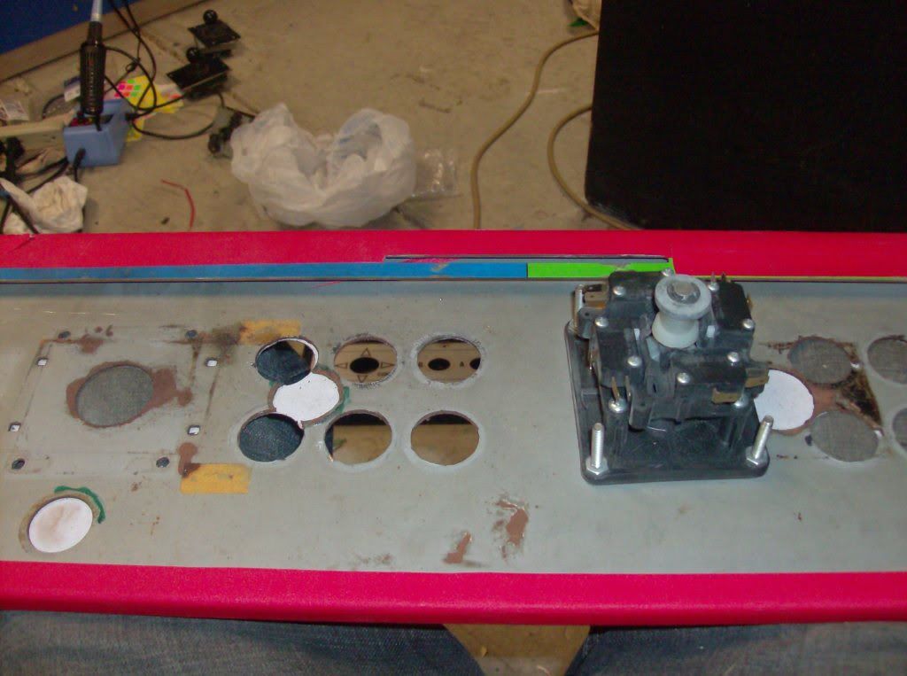

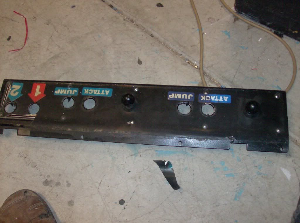

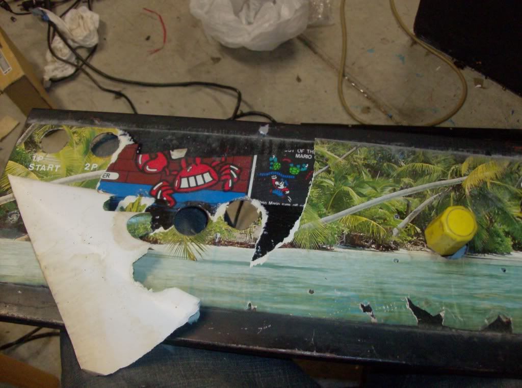

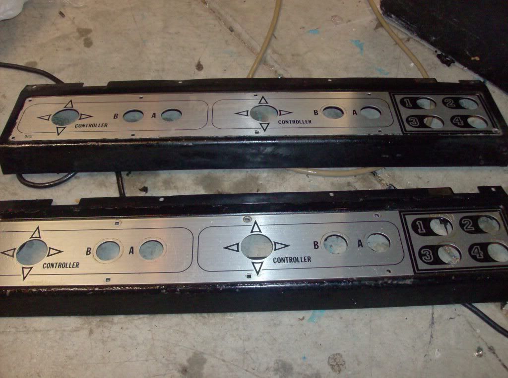

been in the shop today pulling some bolts qbass needed for his nintendo projects
pulled out all the old nintendo cps i had on the parts shelf and went to work
started out on these 2 red tent cps i had they came of a tent that had been converted to some goofy game who knows i only got the cp's
bolth looked like this when i started

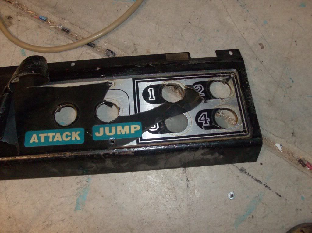

while i was pulling bolts some of the black crap that was used to cover the cp started to peel and to my suprise the old aluminum cpo's were indeed still there and looked intact

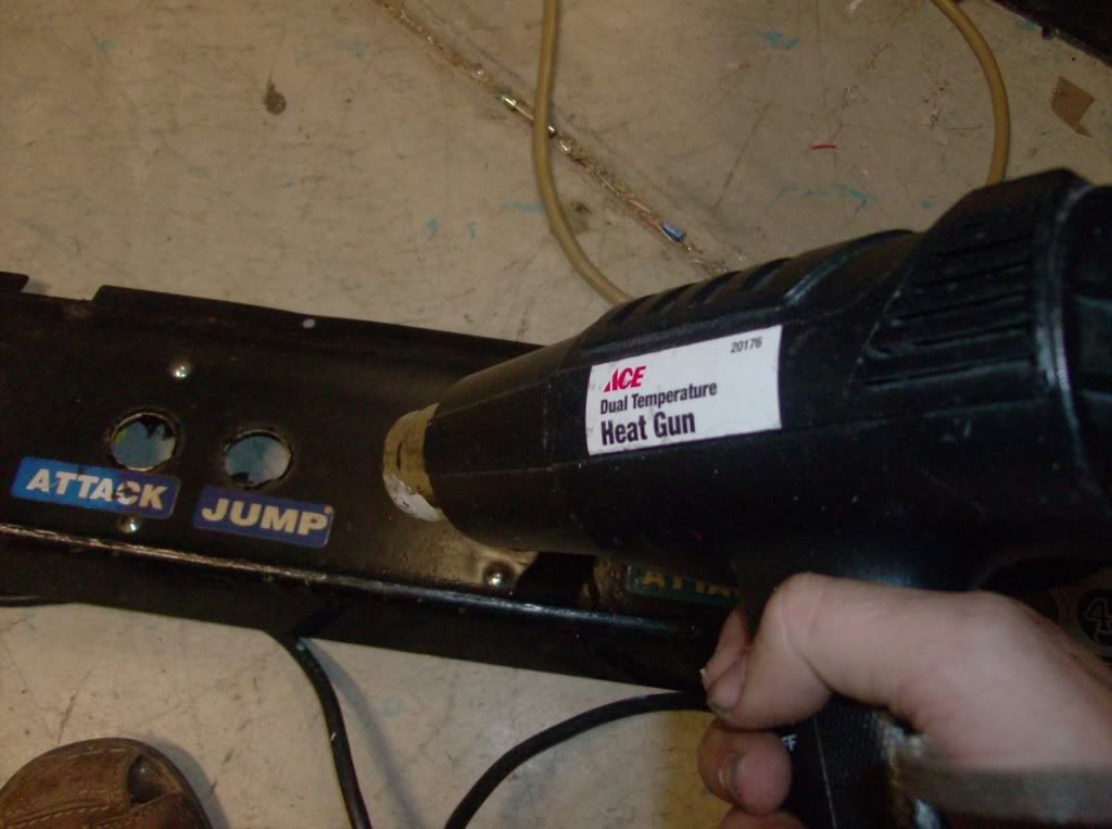

out came my heat gun
and with some elbow grease

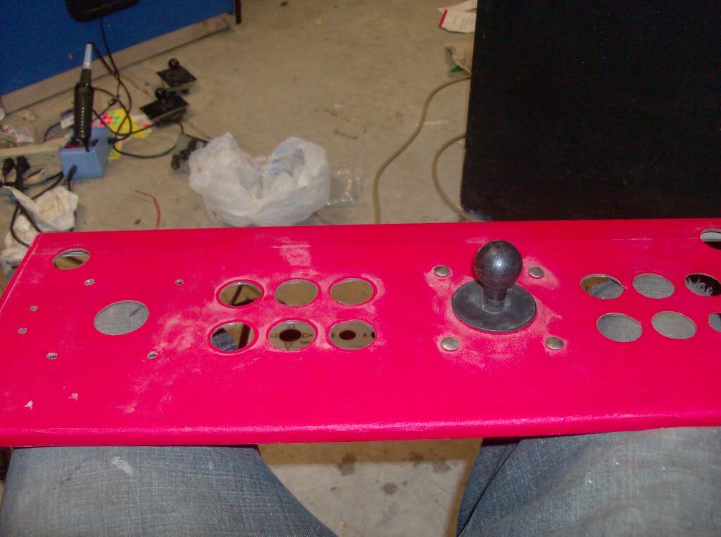

and now i have 2 almost perfect red tent cps
im letting them soak a bit more in googone to remove some small stubborn adhesive left behind and then tommorow ill totaly strip the lower black parts and repaint them
