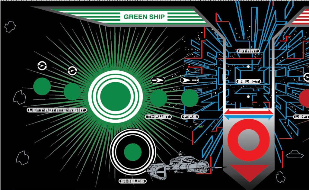

One thing we didn't think of was the diameter of those cone buttons! Doh, can you tell me the size of them and I will make the changes. I will also make the text above each button rather than below.
That looks great!
Please let us know when the changes are made. Im interested in having one printed and making a donation.:)
Thanks for the sizes.
I have made quite a few changes to this revision.
1: I moved the spaceship because the bolt hole for the spinner goes right on top.
2: Added black around the all the text so the background doesn't show through. Makes it easier to read.
3: Added black around the Asteroids rotate icons
4: Added a stroked box around the thrust and fire arrows.
5: Added a black circle around the shields art so you don't see the background spikes.
6: Changed the shape of the red triangle below the spinner.
7: Moved the text Start/Select text so it doesn't get covered by the buttons.
8: Made the Major Havoc art larger.

That looks much cleaner. One thing that your comments made me think of is the asteroids icons.
Since Asteroids one player at a time, isn't it going to use only one set of buttons? The second thing is that you out the icons for everything except shield/hyperspace. It just makes me wonder if you can do without the text labels all together since the keys are the same.
Good points.
I haven't played many vector games, so you think keep the rotate buttons on the green side and the thrust and fire buttons on the red side?
Do any of the other games on the ZVG need the other buttons if I remove them?
Lets have a think about it before the next revision. Maybe someone can look at the CP layouts for all the ZVG games and come up with something universal rather than go this far only to change it. Once it is finalised I can modify everything to suit.
