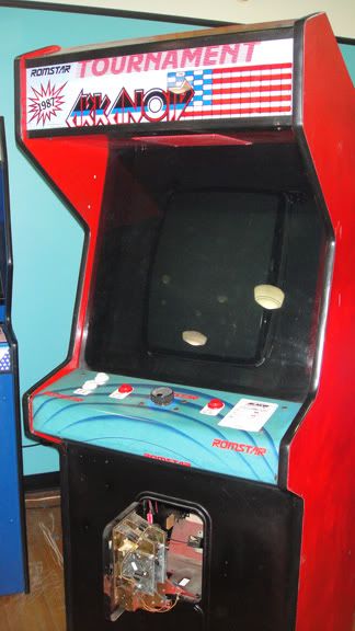

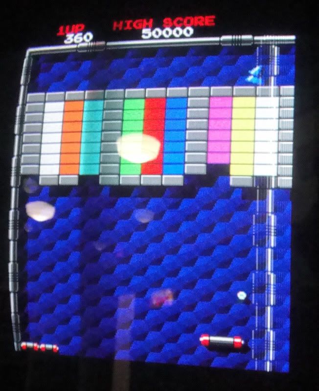

We just go in a Arkinoid upright today. Looked great in the craigslist ad. We had a loyal customer pick it up that swears that the monitor was fine. We finally got the heavy beast inside and plugged it in. The game is playable but there's a little bit of droopy image going on the right side. I checked the board chips and replugged the monitor wiring harness but it didn't fix it. Please tell me that is an easy fix and that I don't have to recap a monitor of a machine that was working 100% 20 minutes ago... I just bought the damn thing!
So I had to take a second look at the now deleted Craigslist ad and the top left pic does show the screen problems. DAMN YOU CRAIGSLIST AND YOUR SMALL PICS!
The Ad:

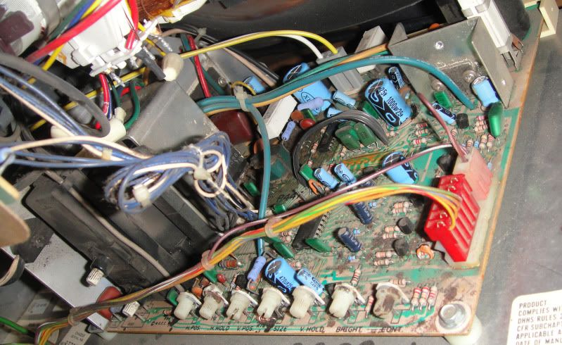

Either snap a good pic of the monitor chassis and post it here so we can help you identify it or click on the links here to see pics and identify it yourself.

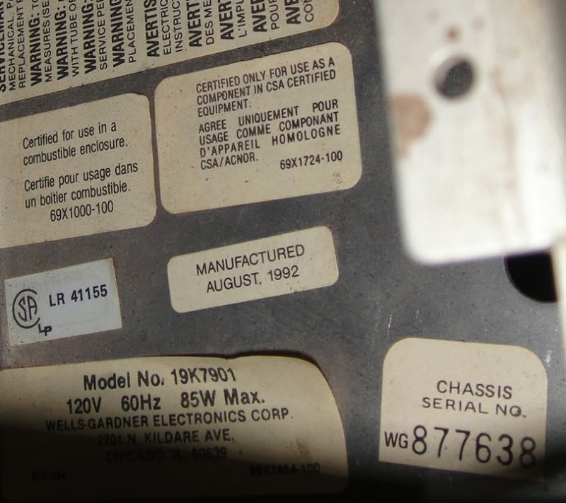

I assume the other person reposted your pic because the label on the frame shows the tag for a WG 7901 which is what the monitor chassis is. Although as per your response it was not clear to everyone and as I previously mentioned the labels can end up mismatched over time so a visual ID is the best case scenario.
Most likely the source you buy the cap kit from will list this as a WGk7000 series cap kit and not specifically a WG7901 but I suppose some sources might list a WG7900 or WG7901 cap kit. I haven't looked at all sources. Pretty sure it will just be WG7000
Without pulling the board out just yet, could anyone identify it and tell me what cap kit that I need for it?
It's a Wells Gardner 7901.
Not sure if a 7000 series Cap kit will work or not, but it looks like new caps in there already. The two dark blue caps might be old though.
It appears to have been capped already with a Bob Roberts cap kit. I'm actually sure that that caps are fine (for a Bob Roberts kit). The dark blue caps that were mentioned are original to the chassis, and don't come with many kits (though they do come with mine). They're the bipolar caps that are inline with each colour (red, green, blue).
What appears to need adjusting are HEIGHT and the 50/60Hz pot. I'd try the 50/60Hz pot first.
I would also replace that flyback. It's got the white knobs, and at this age are prone to failure.

I played with the V and H knobs on the board and got rid of the droopiness but the right side is still cut short and overlapped that side of the screen. Any Help?
