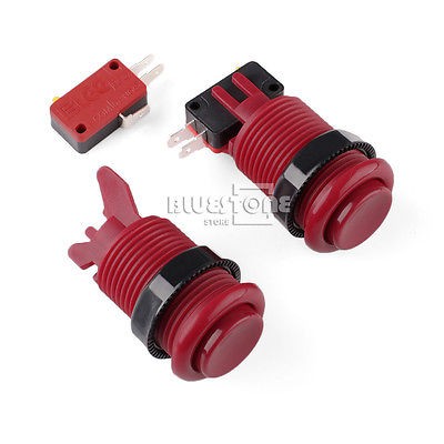

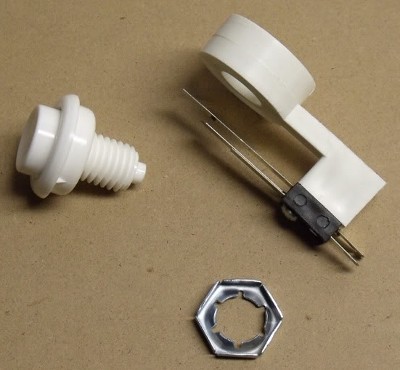

why go with those 1990's new-style happ buttons instead of the cooler retro leaf-style buttons like all arcade classics have?

"Cooler?" Biased much? I don't recall seeing in the kit manual where it calls for leaf buttons ;)
But to answer your question, I've played Arkanoid with leaf buttons and don't like the feel of them when firing the lasers. Just a personal preference of mine, but there are plenty of situations where I prefer microswitch buttons over leaf.

But the thing is, LOTS of "classic" games actually did use microswitch buttons. Did any Nintendo games use anything BUT microswitch buttons?
