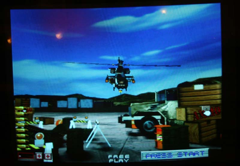

My area 51/ maximum force combo (in a dedicated area 51 cabinet) is displaying faint diagonal scan lines that are driving me nuts trying to fix. I backed the cab up to another cab and hooked the area 51 combo board to the other cab's monitor and it still displayed the lines. I hooked the other cab's pcb up to the area 51 cab's monitor and that game looked fine. So the monitor in the area 51 cab is not the problem. Is there anything on the area 51 combo board that could be causing these problems or is it some kind of cabinet wiring problem?

Here's a pic:

thats an odd one... do the guns still work properly despite the lines? do the lines move around or are they always in one spot? If theyre moving around that reminds me of power supply noise.
