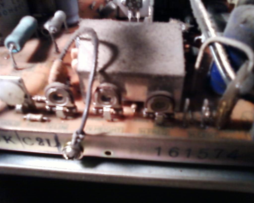

Are these orignal Adjustment Pots ?

Never seen these before are they original ? Do you need a special tool to adjust them ? I think this monitor is a Go7 .

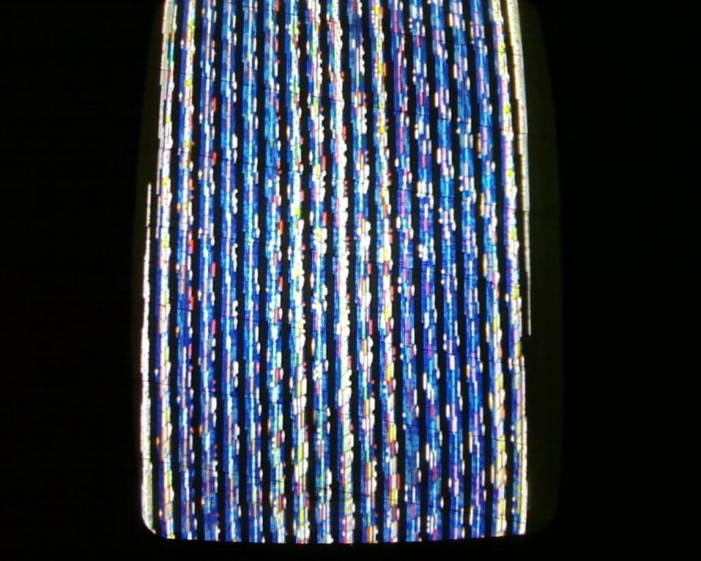

Heres what I'm getting on screen .
Yes those are original trimpots. You need just a small straight slot screwdriver to adjust them, but be sure to be careful, they are delicate. Also, don't let the screwdriver slide through the slot so far as to also touch the metal box behind the pots or you will damage the monitor. Don't let the screwdriver's metal shaft accidently touch the monitor's metal frame either as you adjust a pot.

Thanks Ken !! You saved me from damaging the monitor . With the monitor off I tired out a couple small screwdrivers to see which ones fit and the first two went straight through and could hit that metal box . Yikes !! Thanks for the warning . So I found the right screwdriver and safely got the monitor adjusted , picture looks great .
