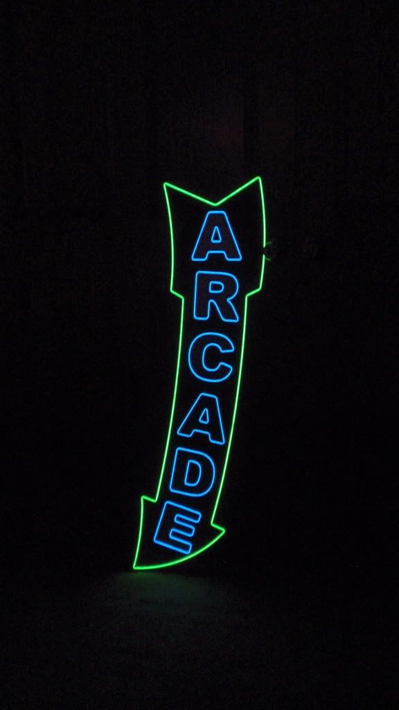

Finally got the chance to put together the second sign that Brett had cut for me. With this one, I decided to go with just the colors of the stripes in my game room, Blue and green. I also went with the 3.3 mm wire, so I pounded it in the 1/8" channel with a rubber mallet, no hot glue needed. With the 2.2 mm stuff, I had to hot glue it all in place. I also went with 2 9V power supplies, so that I can alternate the effect of the border and the letters. Currently, I have the green border blinking, and the blue letters are always lit. For the pics, I obviously had to get them all lit at the same time:

The wife is already trying to get me to get rid of it, saying we have no room. I love this sign. She loves the colors, but not the size. It's huge. I wonder what ever happened to Shar's buddy? He was supposed to design EL interface/control boards to be able to customize the sign's motion. Oh well, sometimes simple is better. I really should take a video of it in action. Looks awesome.

The signs are 3/4" plywood, CNC routed to shape, and then a 1/8" channel is routed for the letters and the border. The EL wire gets either glued or pounded into the channel, depending on the wire size. The sign/base is painted flat black and the letters painted silver. Then silver is dry brushed or 'ragged' onto the whole sign to give it a distressed/ been out in the weather for 30 years look. The wire shows up so well because of the flat black base paint not reflecting much light back around the wire.
