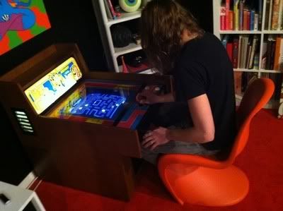

Hey Phet, there was a thread started about a Unique Ms Pac cabinet. Seems to me that it is very wheelchair accessible!
http://forums.arcade-museum.com/showthread.php?t=200440
If you are in a wheel chair, depending how you sit-you'll be so far back from the screen all you see is ceiling. Plus there isn't much leg room.
That practically looks like a cocktail with a marquee installed at the 2nd player position.

What do you think about that Ms Pac above?
I'd think it would be a better design if the monitor was tilted up more to make it more viewable and the CP stuck out a little more so that the person in the chair didn't have to lean forward to play. Not every handicapped person is completely mobile enough above the waist to lean forward for optimal viewing and playing posture...
