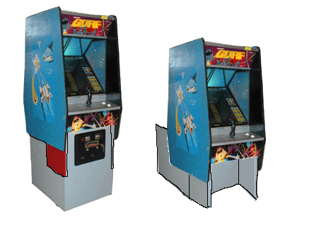

I think a cabinet like your Gorf cabinet would be a good candidate for such a modification. Since the upper part is wider than the base the base could be made to fold under and transform the cabinet from standard height to wheelchair accessible height.
The only thing that would be a bummer in this the coin door would be at a 45 degree angle to the floor in the accessible mode. This wouldn't be much of a problem if the game is set to free play.
In the photo above I am suggesting that the base of the cabinet on the left be cut along the back lines. Then install metal bars so that the top can be lifted and pulled forward to rest at half of the base's original height. The part where the coin door is would hinge (forgot to draw the cut line for that) at the same level and end up at a 45 (not pictured doh!). There would be space for legs under the control panel this way. The whole thing could be motorized to make it easier to transform to accessible mode and back.

In my suggestion of a cabinet that would fold down enough so that the person could play I don't think there would be a problem. In fact all candy cabinets in Japan are played in a sitting position. The monitor angle is not an issue.

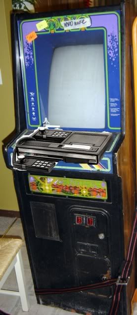

well, how bout this? this is based on my second idea, and again, no pics, but...
a centipede style cabaret, so the monitor is straight looking at you at a lower level, and also the marquee is lower to eye level. have 2 controllers the style the colecovision had, so they pull out of the control panel for handicapped accessibility and then sit back in when not in use.
i thought of the hinge idea as well, but a hinged control panel would probably wear out after a while and break.
so here's a crappy pic... i suck at photoshop, and used paint.

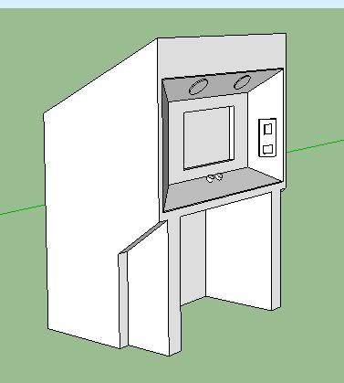

I patterned this (below) after the Space Invaders cab, with a wider front and a shorter height. Depth would be about the same. Coin slot moved up next to the monitor to be more accessible. Inset monitor allows control panel to be mounted in front without extending out from the cab. Control panel height would be about 2.5-3' off the floor, about the same height as a table. Should allow enough room for chair and legs underneath. Speakers above monitor like most cabs. Enough room up top for a marquee, and room around the monitor for a bezel. Adapt different classic cab artwork designs for the sides (Stargate, Pac-Man, etc) and you're good to go.
(I suck at sketchup - which is why there is no art on it - and apparently I can't share it for others to modify for their own use as I apparently either don't have a Google account or have forgotten how to login. if you'd like a copy of this to modify with art and such, pm me an e-mail and I'll send the file.)
