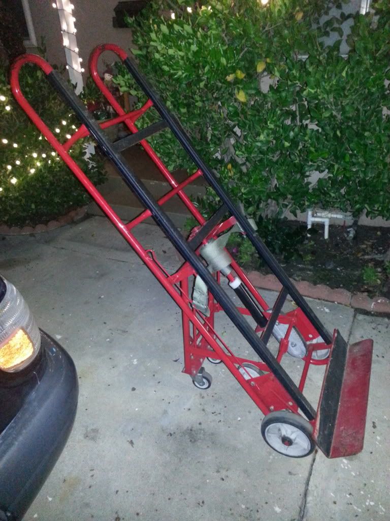

My dolly has the kick back legs on it, best investment for your back it can hold practically any game up without a problem. I've moved my star wars cockpit and my kosmik krooz'r with it and those are big and heavy cabs.
I don't know who made the dolly I have but it is the shizznit! It has the kickback wheels but it is different from every other dolly with kickback wheels I've seen.
The large wheels are the ones that pivot back and then the small ones stay at the base in the front. This is a FAR superior design because you can then balance the game perfectly on two wheels on the back as you roll it...especially over rough terrain. It also makes it easier to go over a step or a threshold too because you can tilt back onto the back wheels easier.
Everyone else that has used it falls in love with it. I've had it for like 25 years now :)

yes, they can hold most any game on a 45 degree angle. They might not be 100% in perfect balance, but close enough where if your on a flat surface you leave it on the angle with no problem. a game like nba jam 4 player will be on the brink of tipping when you grab it from the back. But grab it from the side and the bablance would be good.
I am trying to think of the heaviest cabs I have moved with that type of dolly and I think it was a 2 25" screen title fight I got out of the berkley arcade. I had to move it about 1000 yards to my truck and it rolled pretty well.
Not sure if the northen tool dolly is as strong as my 1980s escort 4 wheel dolly, but I have put all the weight of a cab on the rear 2 wheels when going over steps/thresholds. Put the rear wheels over the threshold and pull back and lift the front wheels off the ground and pull the game into the building. It works great!
can't give a higher recommendation to get the 4 wheel dolly with solid wheels. Its worth the added weight. I would go with this one.
